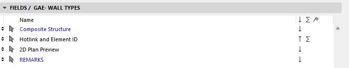

List Wall ID in an ascending order
Gisele
Attached are screenshots of the wall legend; how to have the IDs listed in an ascending order?

You are sorting the list by the composite structure first, so that is what controls the order of the list.
Only if you have 2 identical composite structures with th ID then be listed in order.
Turn the sorting for composite structure off.
