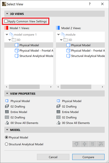

Compare Two Views of a Single Project
This workflow is recommended when you want to compare the content of two different views of the same project, e.g., two different 3D views: the existing and the proposed site plan.
In this case, Model 1 and Model 2 will both be the current model. You need to use the View Selector button that opens the Select View dialog.
To be able to select these two views to be compared, uncheck the Apply Common View Settings checkbox.

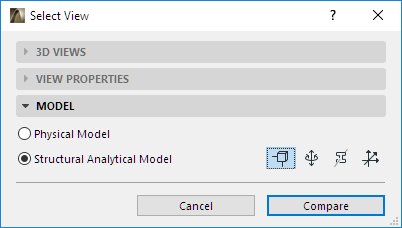

Compare Two Structural Analytical Models
Use this workflow when the structural engineer has sent the revised analytical model back to you after carrying out structural analysis.
In this workflow, select the current model for Model 1. For Model 2, browse for the SAF file (Structural Analysis Format) sent by the structural engineer.
Click the View Selector button. The Select View dialog opens.
Open the Model panel of the dialog, select Structural Analytical Model, then activate the components you want to display in the Compare window. Then hit Compare.
The components can be the following:
  • Nodes
  • End Releases
  • Profiles of Load-Bearing Cores
  • Local Coordinate Systems
See also Select View for Compare in the next section of this article.

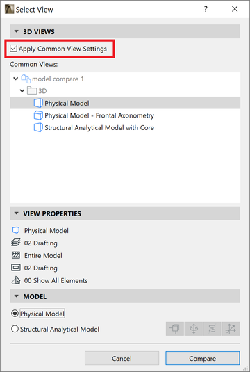

Two different scenarios are possible:
  1. To compare two 3D views that are common to both models: Select the view, then click Compare.
  2. To compare two different 3D views of the two models:
    Uncheck the Apply Common View Settings checkbox.
    The 3D views of each model version are now listed separately, side by side.
3D views common to both models
In both cases, you can review their view settings in the View Properties panel, right below the 3D Views selection panel.

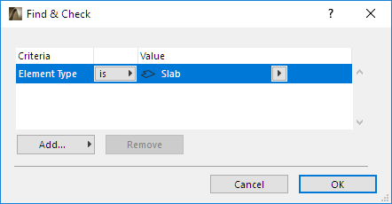

Filter by Element Criteria
By default, all changed elements are shown in the list. You can narrow down the list by defining the criteria for the elements to be shown. Use the Filter by Criteria button to access the Find & Check dialog where you can set up your custom criteria set.
Info_18x18.png NOTE: you cannot save custom criteria sets.

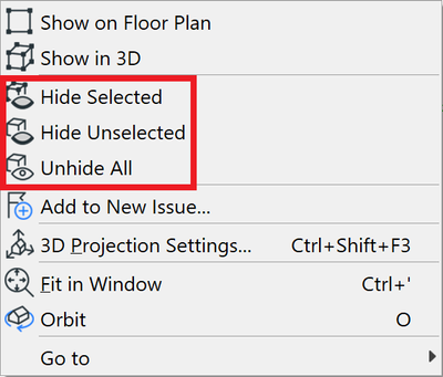

  • For a selected item in the list, you can use the context menu commands (available after a right-click) to display them in the model:
    • Show on Floor Plan or
    • Show in 3D
  • To get a better view of the changes, you can hide the selected element(s) or all other elements by using the Hide Selected / Hide Unselected commands in the context menu. Then you can restore their visibility by using the Unhide All command.
