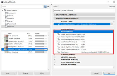

The new Building Material properties are in the Environmental Property Group:
Environmental building material property descriptions
Hover over the name of the property to read a description.
The last property in the group is the Data Source, which is a link that takes you to the page of the selected Building Material in the ÖKOBAUDAT database.
