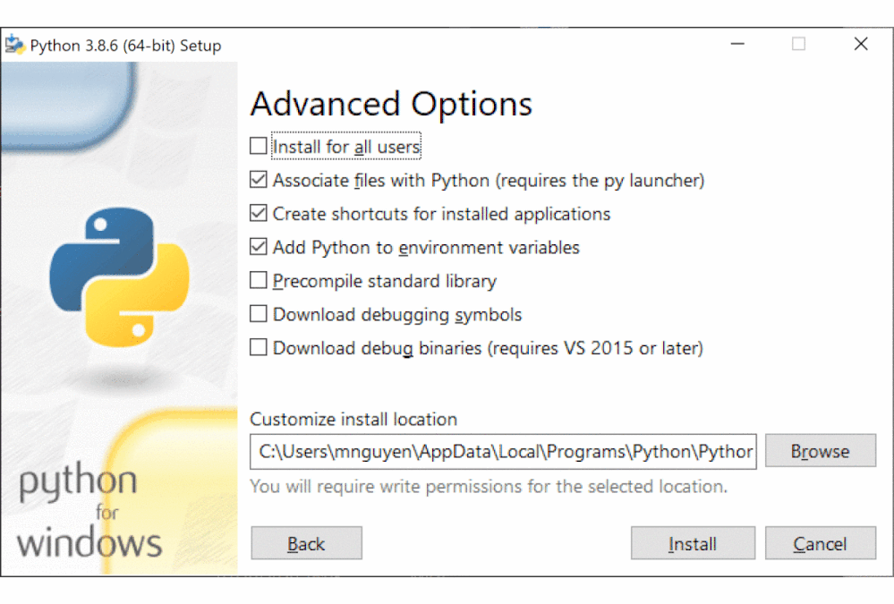

On Windows 10
  • Double click the executable file.
  • Click Install Now to let Python install with the default options.
  • Alternatively, choose Customize installation if you want to select which features to install and where to install.
    For advanced users: we recommend adding Python to the PATH environment variable, installing py launcher, and associating script files with Python. These options can be found in the Optional Features and Advanced Options section of the Python installer. With these options running a Python script becomes easier.
  • Once it is finished, click Close and the Python environment is installed.

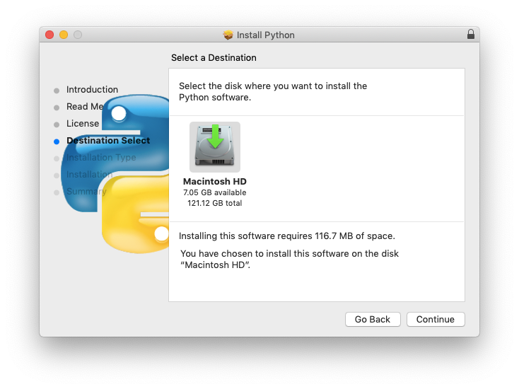

On macOS
  • Double click the downloaded installer file.
  • Click Continue. The installer will walk you through the Important Information and Python's License Agreement.
  • In the next step, it will ask for the location where you want to install Python. Please leave it at the internal drive for future compatibility.
  • To customize which elements to install, click Customize at Installation Type; or leave it at Standard Install.
  • The installation process will start after clicking Install. Once it is finished, click Close to close the installer. You may choose to delete the installer if it is no longer needed.

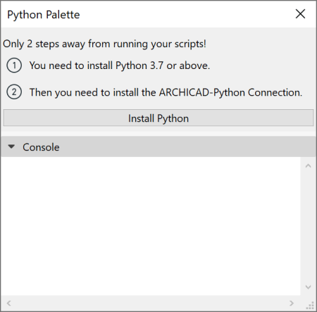

Although we can run a Python script without Archicad, the Python Palette will provide a more user-friendly way to manage and run the scripts. To open it, the Python Palette Experimental Feature must be enabled via the Work Environment dialog.
Enable Python Palette
  1. Go to Options > Work Environment > More Options
  2. Under Experimental Features, tick the Enable Python Palette checkbox
  3. Open the Python Palette from Window > Palettes > Python Palette

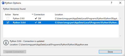

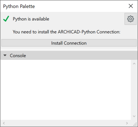

The Python Palette will notify you if something is missing from your computer. If Python is not installed, then the Install Python button will open Python's official web page for downloading the latest version of Python.
If the Archicad - Python connection is not yet installed, the Install Connection button automatically installs the missing package.
Once the connection with Python is made, we are ready to run some scripts via the Python Palette.
To know which version of the Python environment is being used, click the wp-content_uploads_2020_10_info.png button. The wp-content_uploads_2020_10_cogwheel.png button will let us choose different versions if we have more than one installed.

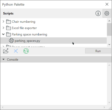

Managing script in the Palette
The Python Palette contains some basic functions to manage and run Python scripts.
It can show the scripts stored in multiple places on your computer. Click the wp-content_uploads_2020_10_browse.png button to add a folder. The palette will list all runnable scripts inside the main folder (it cannot look into any sub-folder).
The wp-content_uploads_2020_10_refresh.png button will refresh the list: the palette will check if there is any new script in the added folders, or if a script is moved/deleted.
While a folder is selected, clicking wp-content_uploads_2020_10_delete.png will remove it from the palette. A dialog appears to confirm the action.
Run script via Python Palette
To run a script in the Python Palette, you can either
  • Double-click the script in the list
  • Select the script and click the Run button
The events will be shown one by one at the Console field of the palette. Once the process is finished, the palette will present the result with notification of whether the script ran successfully or not.

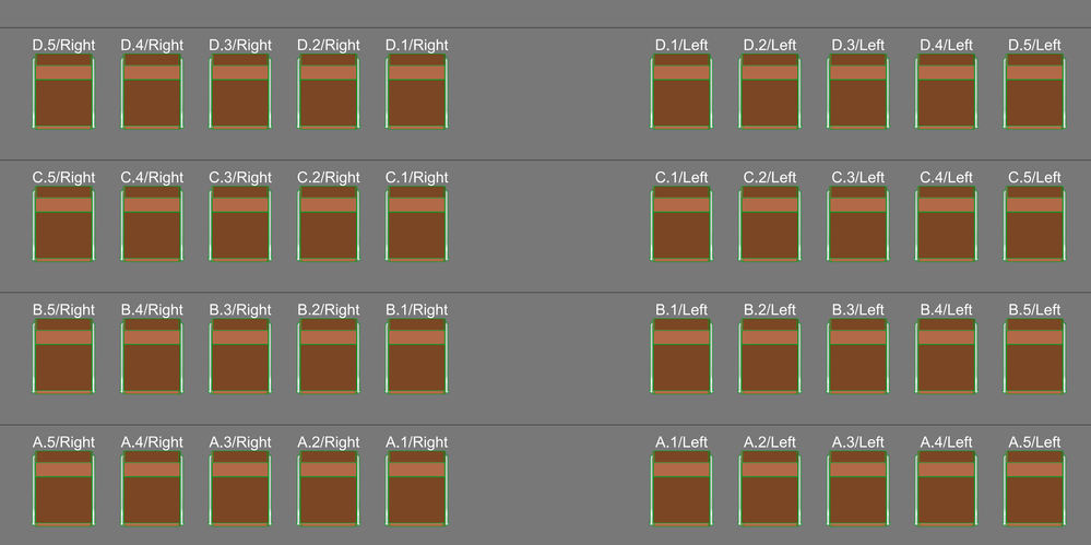

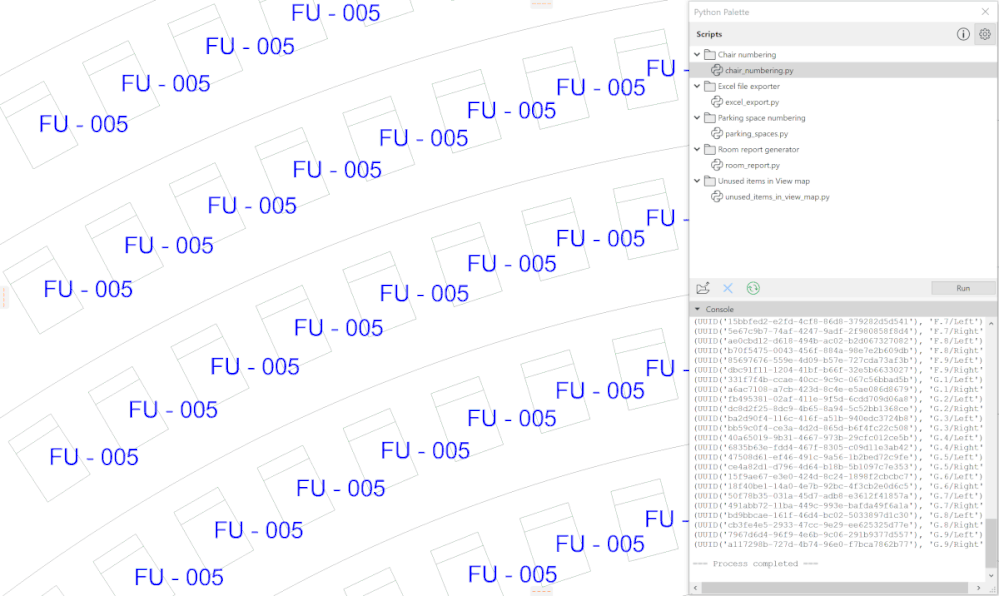

Chair numbering
We usually use the Multiply tool to arrange the chairs inside an area (i.e., auditorium). However, when the chairs are multiplied, the original object's element ID is also transferred to all new objects. To quickly re-number them by changing the element ID, we created a demo script called Chair numbering.
When the script is executed, the IDs of all objects classified as Chair placed in all stories will be modified. Hidden objects are not affected by this.
Execution
  1. Download the script here.
  2. Extract the downloaded ZIP package into a folder.
  3. Open the example project file or your own project.
  4. Open the Python Palette by navigating to Windows > Palettes > Python Palette
  5. Add the script to the palette by browsing the folder where the script is placed in.
  6. Run the script by selecting it and press Run, or double-clicking the script.
  7. The element IDs of the chairs will be set automatically. The labels in the example project display the value of element ID on the floor plan view.

The script uses the Z coordinates of the objects to identify the rows. By default, chairs are grouped into rows if the maximum difference between the Z coordinates of the chairs in the same row is less than 0.25m.

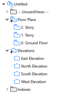

Move unused items in View Map
This script will find any unused items in the View Map and move to a new folder. An item is considered unused if it is not placed on any layout and is not referenced by any Publisher Sets.

  7. The unused items will be moved to a new folder called -- UnusedViews -- in the View Map of the Navigator.
