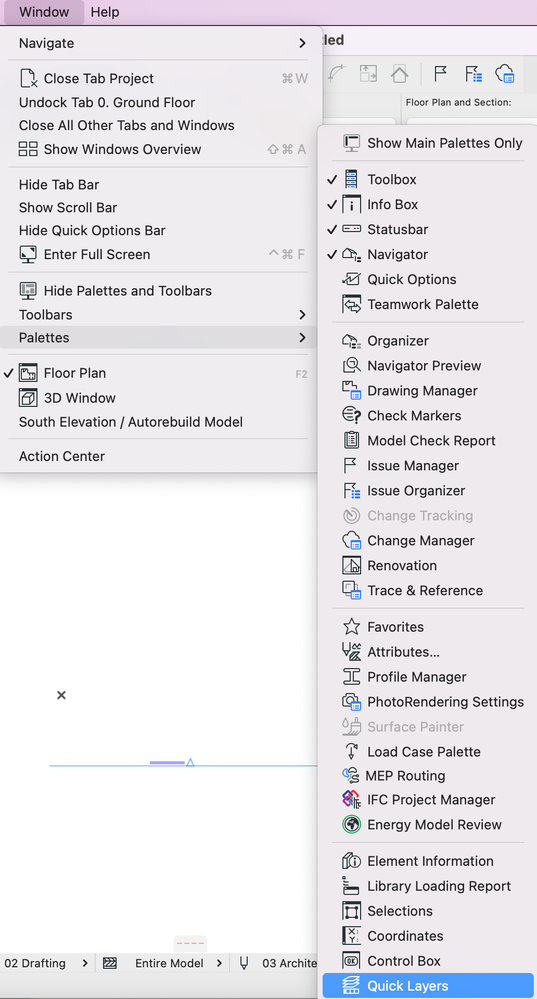

To show (or hide) the Quick Layers palette, simply select Window / Palettes / Quick Layers.

The palette will appear onscreen and can be dragged to a convenient location by its title bar.
The palette can be hidden by clicking on the Close button in the title bar or selecting the Quick Layers command again. As with all other commands in Archicad, you can create a keyboard shortcut in Options / Work Environment / Keyboard Shortcuts or add a button to the Toolbar to show or hide the palette with a single click.

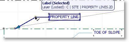

  1. Click the Show/Hide Toggle button. Now all the layers that were hidden are showing, and all that was showing are now hidden.
  2.  Select one or more (formerly hidden) elements you would like to make visible for the next modeling or editing task — in this case, one of the property lines and its label:wp-content_uploads_archicadwiki_quick-layers-palette--5.jpg
  3. With these items selected, click the button to Unlock the Selection's Layer (this step is optional, and only necessary if the layer is locked and you will need to edit the data):Screenshot 2022-12-02 at 11.03.31.png
  4. With the items still selected, click the button to Hide the Selection Layer:Screenshot 2022-12-02 at 11.02.32.png
  5. Finally, click the Show/Hide Toggle button (the one on the far left used in step 1).
    At this point, the "missing" property line layers are now showing, along with all the original visible layers.
Once you get used to this sequence, it takes only a few seconds: Toggle, Select, Unlock, Hide, and Toggle back. You can virtually instantly "retrieve" information from one or more hidden layers using this method.

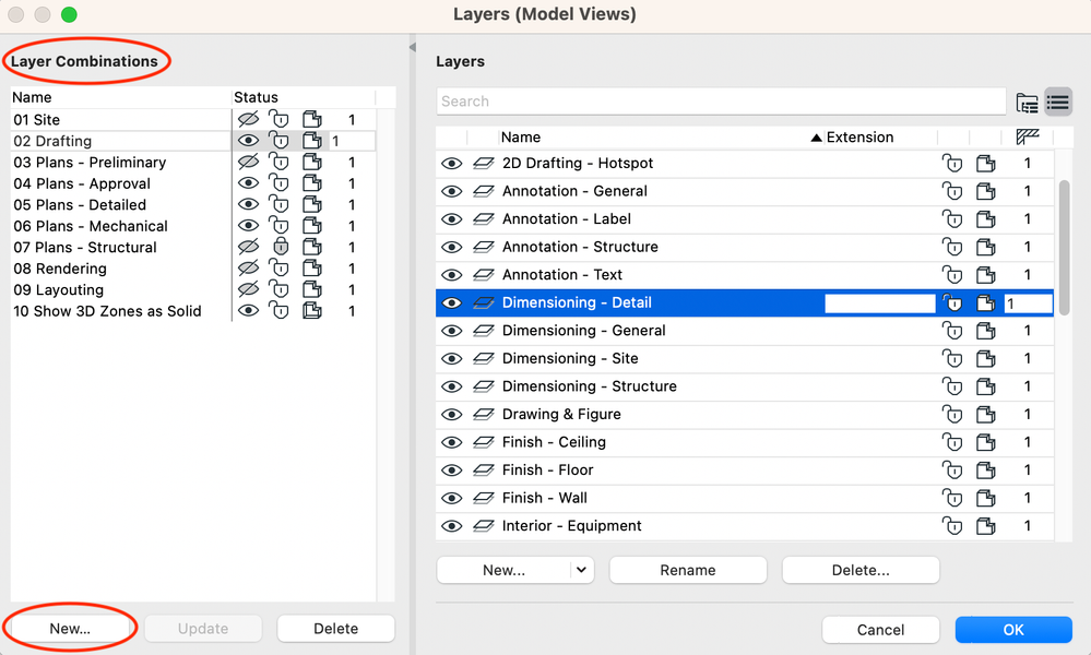

TIP: If you haven't been using the Quick Options palette, this may be unfamiliar to you. It can be shown or hidden using Window / Palettes / Quick Options, or by clicking the Quick Options button (third from the left at the bottom left of most working windows, next to the drawing scale button). Quick Options is often docked or snapped below the Navigator but may be moved around as desired. The Quick Options palette is also one of my personal favorites since it allows instant manipulation not only of layer combinations, but also model view options and more. Note that the Archicad v12 version of Quick Options (pictured above) has been expanded and now also controls pen sets, partial structure display, and dimension settings. If you need to re-use this particular custom layer combination, either for modeling/editing or for output, then it may be appropriate and useful to create and name a new Layer Combination in the Layer Settings dialog box:
If you don't need to re-use this custom layer combination, then when the current modeling or editing task is completed, simply choose a layer combination from the Quick Options palette, or double-click a view in the View Map to activate a layer combination.

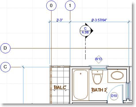

Now you have a simpler view in which to work:
If you'd like to hide additional layers, simply select items on those layers, and click the button again. After completing the task, you can step back through the layer manipulations by clicking on the Undo QuickLayer Actions button:

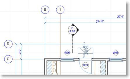

Now (in this case) you have a view of just the walls:
