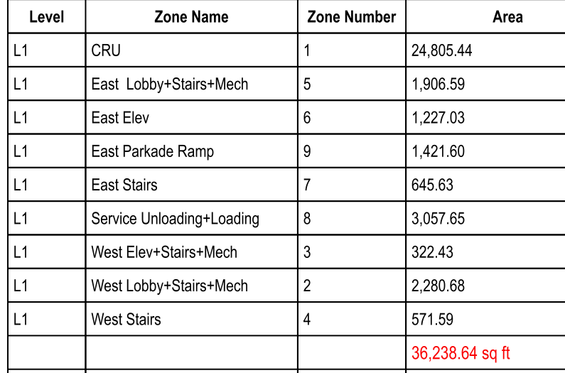

I have two separate towers within the same lot.
1. How do I separate the schedule into two separate sub-totals by levels [stories] ?
2. How do I calculate the leasable area efficiency [% leasable to gross floor area] ?
Right now I have both on the same sub-totals in the Schedule - See screenshot.
I have to manually entered them into Excel…a lot of duplicate work!
Thank you

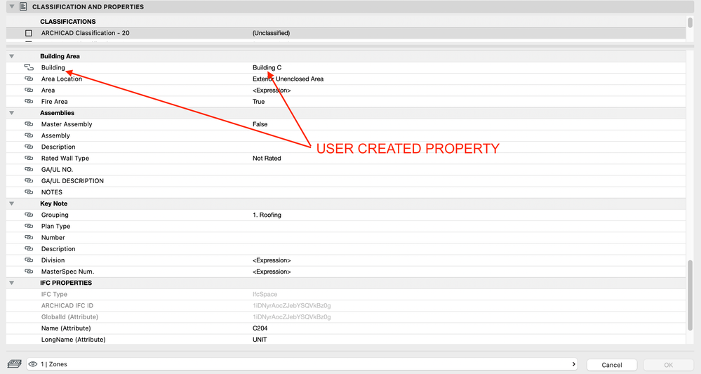

2023-03-16 05:22 AM
he means using this...
creating a new Property & associating elements to them.

2023-03-16 03:31 PM
Oh jeez, I just noticed you are on Version 20. I think user defined properties were introduced on that version, but I could be wrong. If it is available can just create a property that defines the building number/type or however you would like it to appear, and make sure that property is accessible and definable within zones.
