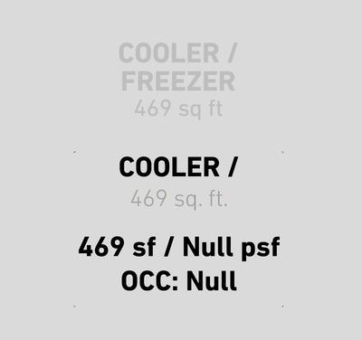

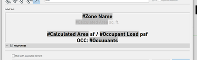

Does anyone know how to call the 2nd line in the Zone Stamp 02 26 for autolabeling?
We are trying to use Labels to show additional info for our Building code plans, and just came across my first instance of a 2nd line of zone name being used, but couldn't find a way to pull this info from the zone.
I also checked our zone schedule, and it too was missing the 2nd line.
The light gray text at the top is the actual zone stamp.
Below is an autotext label pulling the info from the zone and our custom properties.
Any help or suggested workarounds would be appreciated.
