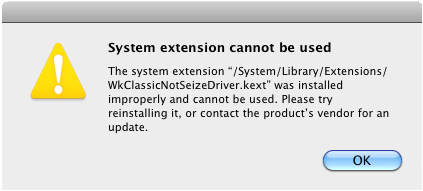

This problem affects ARCHICAD versions 10-12: During the installation process the following error message may appear during WIBU Key component installation:
The problem may not occur on computers where Rosetta environment is not installed. Hit OK to continue installation. The installation will finish successfully, and ARCHICAD will work. However, the same error message may appear again several times while working in ARCHICAD. To fix this problem, you need to install WIBU Key driver version 5.30, available from here: http://www.graphisoft.com/support/archicad/downloads/WIBU.html
NOTE:The driver available on this page is not the same distributed on wibu.com. Use the driver distributed by Graphisoft

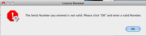

This problem affects ARCHICAD 12: Entering a new (and correct) serial number in the License Renewal dialog results in the following error message:
The workaround is to uninstall ARCHICAD, and reinstall it again. Entering the Serial Number during the install process works.

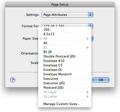

This bug is fixed in ARCHICAD 13 Hotfix 2 build 3235. This problem affects ARCHICAD 10-13: In the page setup dialog certain paper sizes are not selectable (grayed out). These happen to Paper sizes have multiple sub-options. The workaround is to define the paper size manually. (click 'Manage Custom Sizes' at the end of the list)
