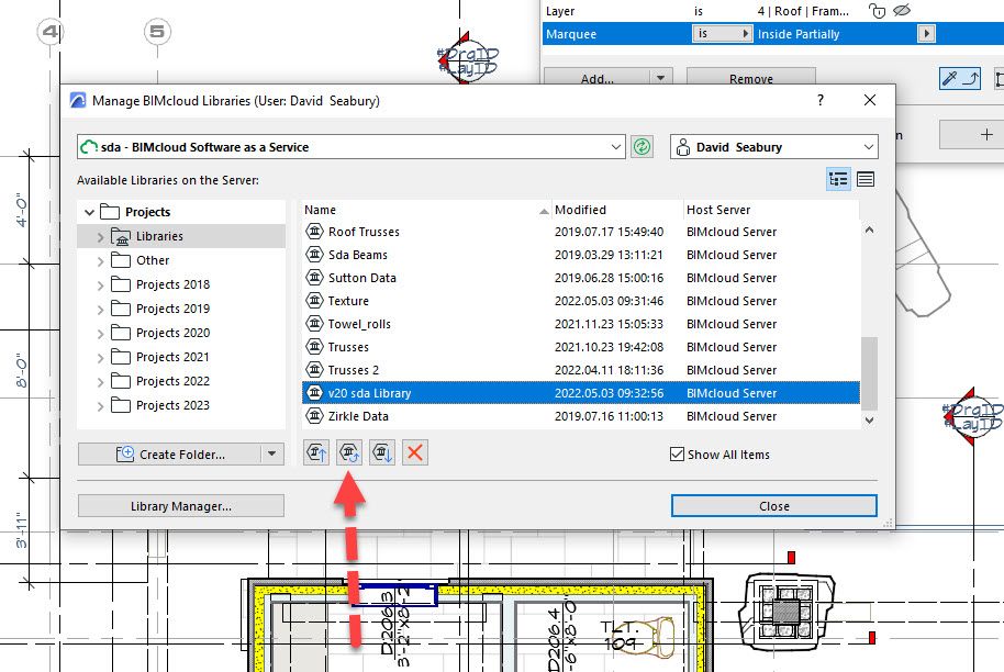

tranobago
I'm working on some standards for my office and I created some materials with textures but I can't figure out how to upload these to a running BIM server in our office.
I have a specific detail library hosted on the server. I could delete it and upload the updated one with said materials but that seems complicated.
1 REPLY 1
Dave Seabury
Tranobago
On your server let's assume that you have a folder "Office Library" that
was up loaded from a project or directly from an office computer.  open this
folder and add the new materials then
Libraries and Objects > Manage BIMcloud Libraries... Update BIMcloud Library with local copy
This will update the server library, when you are done, you will be prompted to reload the library
in your current project.
David
