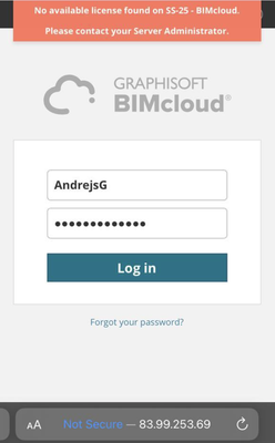

Hi!
Question about BIMcloud manager access rights.
As a BIM manager for current office I work, I decided to create numerous users (contractors, MEP engineers, etc) with different access rights to different folders for BIMcloud project.
As it turned out - only one non-Archicad user was able to access simultaneously BIMcloud manager.
Is it really meant to be so, or is there somewhere some configuration needed?
Hope very much that involved parties does not need to buy AC license to download/upload documentation files in BIMcloud manager? 🙂
Thx,
Kaspars

Hi Kaspars,
Log in to BIMcloud is tied to the licensing - when one is signed in, they acquire a license and keep it up until they sign out.
In this case you either need to have some extra licenses available for your contractors, or in case of BIMcloud SaaS you can invite contractors with their Graphisoft ID and configure their users to use only their borrowed license from their own tenant.

Thx for answer!
That's Huge disappointment, That puts the use of BIMcloud server for documentation almost useless as there's no way that hundreds of involved people will buy costly Licenses to share documents through BIMcloud server.
So BIMcloud server wisely can be used only for Archicad in-team users but not for even minimal, limited CDE needs.
Kaspars

You are right, BIMcloud is a collaborative design solution, but unfortunately, it is not a Common Data Environment (CDE) and does not offer functionalities that most common CDE applications offer as it is not its intended use case.
Of course, you can always post wishes about it if you need such a functionality.
