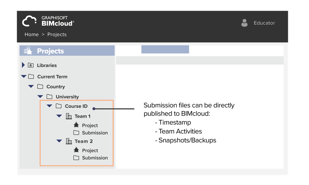

CAD/BIM course
In this scenario, an Educator leading a CAD/BIM course tasks the students with remodeling a chosen building using Archicad. The class then splits into multiple teams, which must submit the project online at the end of the course.
Community - BIMcloud Article figures-02.pngIn this case, a dedicated space can be set for the educator to manage the course:
  • The educator signs up and sets a Course ID
  • Each Team leader signs up, identifying themselves with the Course ID
  • Team leaders each receive a unique Team ID
  • Team members sign up using their respective Team ID and Course ID
This is how the course and teams will be set up in the BIMcloud manager:
  • The Course ID defines the folder containing all the team projects connected to the course.
  • In this case, the educator will have full access to the Course folder, which will allow them to see each Teams’ project files.
  • The educator can then use their access setting to prepare/add prerequired files and oversee each team’s progress.
  • The students can only see and access their own team’s dedicated space.
  • The students can create a dedicated submission folder in their team space, where they can publish the following:
    • Project documentation exported directly from Archicad into BIMcloud
    • PLN files or PLA for archiving
    • BIMx file as project overview (which is fully visible in BIMcloud manager)
…and other files the educator can review for final evaluation.

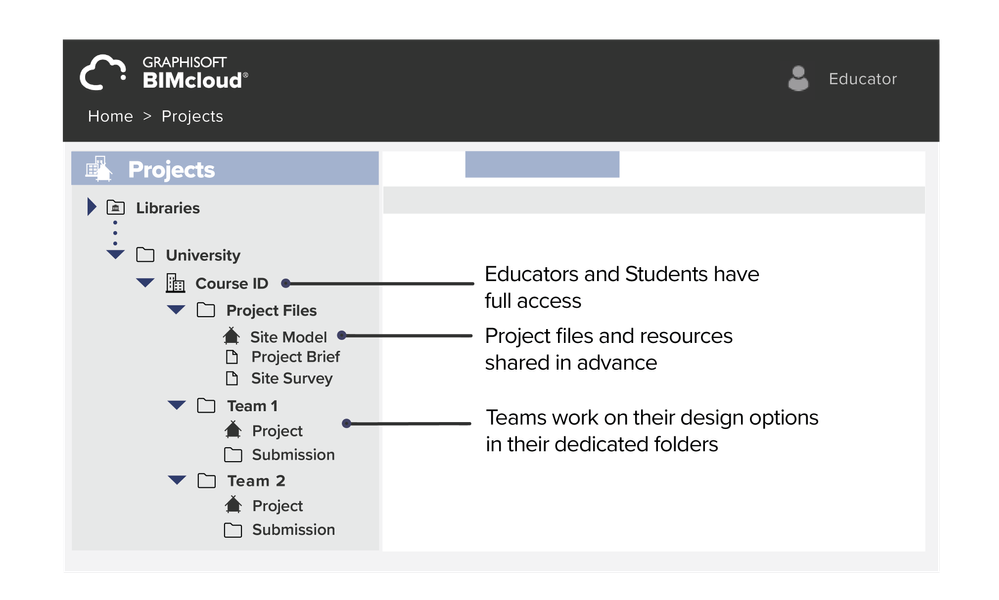

Design course – One site with multiple design solutions for the same site
In this scenario, an Educator leading a design course tasks the students with creating a unique design proposal.
The class might then split into multiple teams, resulting in various design options for the same site. Students might then want to share each other’s progress and compare their design outcomes.
Community - BIMcloud Article figures-03.pngIn this case, a single space can be set for the educator to manage the course and for the students to have visibility of each team’s progress:
  • The educator signs up and defines a Course ID
  • Every student signs up to BIMcloud as a Team Member using the Educator’s Course ID as an identifier
  • A BIMcloud project will be created using the Course ID
  • Both the Educator and the students will have full access to the BIMcloud project.
  • The Educator can create folders within the BIMcloud project and share any necessary documents with their students.
  • The Educator can create folders within the BIMcloud project dedicated to each team.
  • Students share their Archicad project and any relevant files in their dedicated folder assigned by the educator. They will also be able to create sub-folder structures.
  • This flat BIMcloud project structure allows for higher transparency and creative exchange between peers.

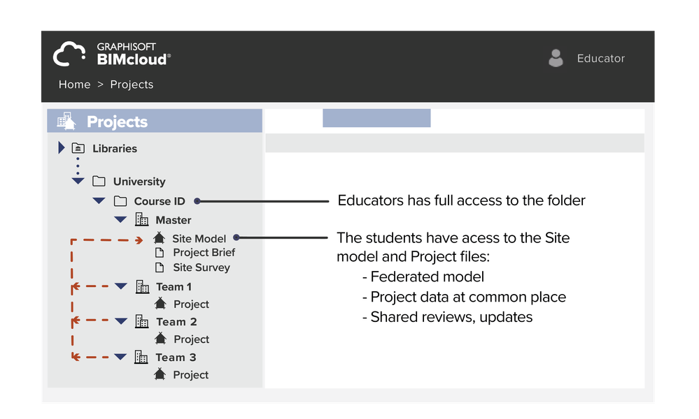

Design course – Multiple sites belonging to the same development = Multiple teams = Multiple buildings.
In this scenario, an educator leads a design course in which the project is an area development; a base site broken into multiple plots. The class splits into Teams, each focusing on one of those plots. Their design outcomes at the end of the semester will be unique neighboring buildings.
Community - BIMcloud Article figures-04.pngIn this case, a dedicated space can be set for the educator to manage the course:
  • Each Team selects a Team Leader
This is how the course and teams will be set up in the BIMcloud server:
  • A folder will be created labeled with the Course ID
  • The educator will have full access to the folder.
  • The educator creates a Master BIMcloud project.
  • Students have permission to view the Master project.
  • The Master project contains the full Site model, project files, updates, and shared reviews.
  • The Course ID folder contains every Team’s BIMcloud project.
  • The students will have access to their Team’s space and will be able to share information or updated models in the Master folder.
