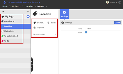

BIMcloud SaaS - Management features and tools
In this article we would like to talk about the management aspects of BIMcloud SaaS (Software as a Service) concerning its features. If you are new to BIMcloud SaaS, this article provides a quick introduction to management tasks and possibilities, as...

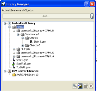

Breaking Hotlinked Modules in Teamwork
When having Hotlinked Modules in Teamwork projects you might have run into the problem of not being able to break the hotlinks as in the solo projects. Reserving the modules and/or the Hotlink Manager dialog itself doesn’t solve the problem either, t...

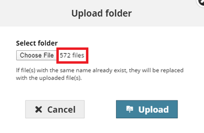

Limitations of BIMcloud File Server
From BIMcloud 2020.2, as a licensed feature (available in BIMcloud and BIMcloud as a Service), BIMcloud Server can handle files, such as PDFs, IFCs, or MOD files, which connects to one ore more Archicad Teamwork projects. Uploaded files can be access...
wp-content_uploads_2020_05_bimcloud-limitations-one-file-server.png wp-content_uploads_2020_05_bimcloud-limitations-one-file-server-2.png wp-content_uploads_2020_05_bimcloud-limitations-upload-limitation2.png wp-content_uploads_2020_05_bimcloud-limitations-upload-limitation.png
