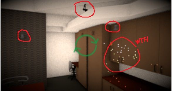

Spotlight 20 and the bar light are working okay, but I can't get Halogen Recessed 20, spotlight ceiling 20 & spotlight wall 20 to produce light. Have spent almost 2 hours today trying and checking every
setting I can find on these both in CineRender. Has anyone had this problem with these? Under the spotlight wall and halogen there are what looks like large snow flakes, but no light on the surfaces.

Here is a picture of what I'm running into. 3 lighting types not working! instead of lighting the surfaces they are producing strange spots and snowflake like things.
Here is another image
Since your image has the green arrow, I am guessing that this is the PhotoRender Preview, not an actual photorender. The Previews are not perfect, so try an actual photorender to see the result. You can also post a screen shot of the Lamp Settings > Light Settings for the Lamps that are not working, as well as the name of the Scene you are using, and someone may spot the issue.
David
