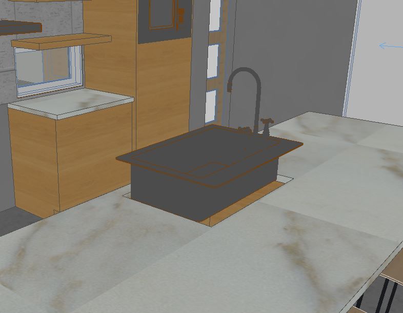

Anyone experience this problem and a have a solution or work around.  Interior of the sink bowl goes missing in twinmotion.  No SEO on the sink and the sink and cabinet base, which is a slab, intersect one another.  Archicad 25 Sink object.  Can't control inside of sink material in Archicad or apply a material to the inside of the sink in Twinmotion.

I don't use Twinmotion enough to remember the correct terminology.
But I think in Twinmotion you can set a material to be double sided - or something like that.

Nailed it Barry!!! Thanks so much.  Just getting in to twinmotion as well.  Thanks again. Jim
