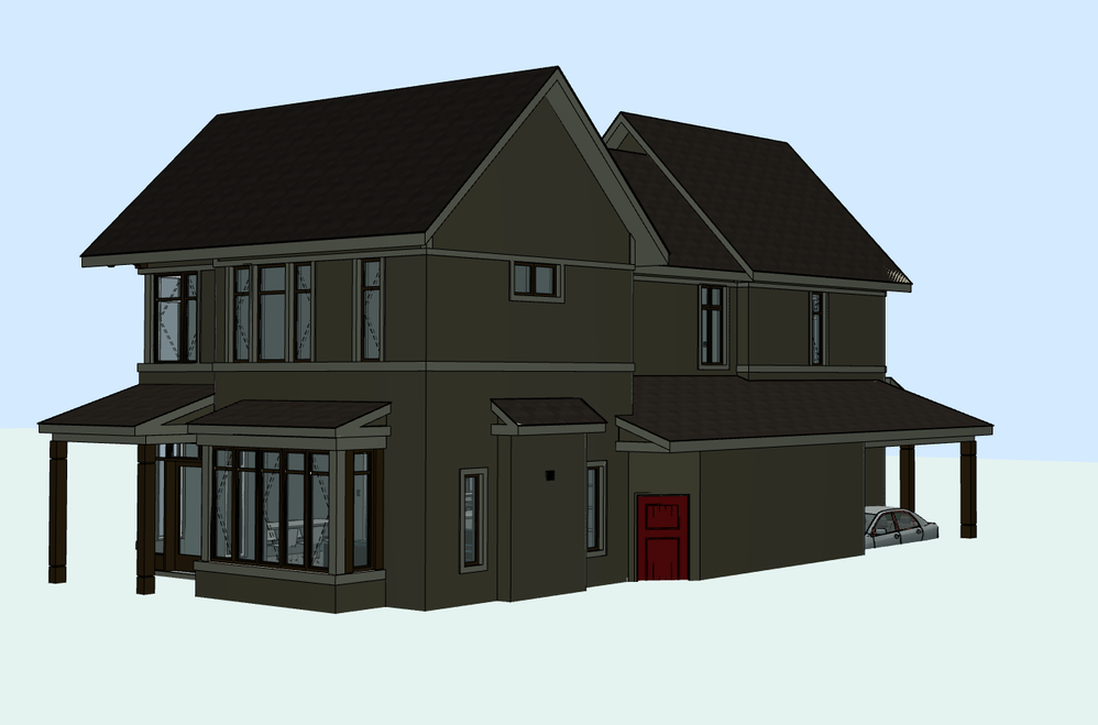

Hello,
Whenever I select my model (or a portion there of) in 3D view, I get this overlay and I cannot turn it off. It saves with this overlay as well. When I render it does not appear.
I use ArchiCAD 15, we have a number of licences and when I open it up on our other computers it does the same thing. On older projects it does not.
I have mashed the keyboard a few times and selected random things and cannot turn this off?
Any ideas?
Thanks...
1 REPLY 1
Erika Epstein
Take a look at your Editing Plane display both in your
Work Environment>View>Editing Plane Display
and under View>Editing Plane
Erika
