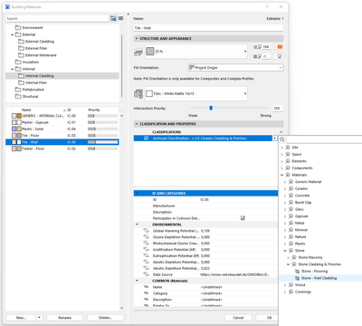

Mapping the material is important only if you want to export your project to ifc in such way that you have the material data included. In AC26 you need to apply the material classification - Options > Element Attributes > Building Materials - you already created a new material here, now in this UI window, under the Classification and Properties > Classifications you need to assign the correct  material type using the Archicad v2.0 Classification system, which is pre-mapped to ifc entities.
If you don't use the pre-set v2.0 classification system you will need to set this mapping based on a custom translator and archicad properties one by one youself via File > Interoperability > IFC > IFC Translators, but I would recommend you to use the existing classification system, make a translator-set copy and do whatever customizations you need based on this translator.

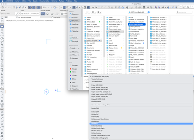

 I don't know why the texture is in an .ifc format, but ArchiCad is able to directly open .ifc file.
Just run ArchiCad, then Browse for a file to open
and choose the ifc format.
The file should open.
If you want send the .ifc file, I'll take a look at it.

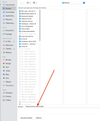

Hi
The file you are showing is a .zip file, it's a compression format.
Just unzip it to obtain the original .jpeg original image file that you can add to you project Library.
You then create a new Surface attribute that use that texture file.
