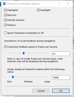

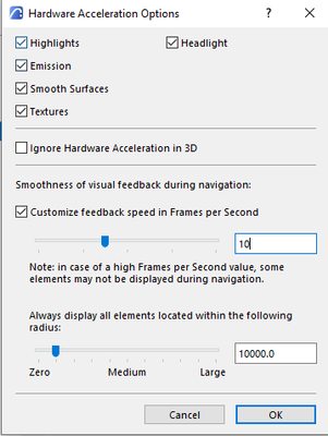

Is open GL no longer available in archicad 26?
Vlad174
The hardware acceleration option looks very unnatural and
3 REPLIES 3
AllanP
Since Archicad 25 it has been called hardware acceleration.
it stills has the same settings.
Archicad 24
Archicad 25
Archicad 26

The change was just a UI simplification due to iOS moving to Metal.

Yes. From Archicad 26, Direct3D replaced OpenGL as 3D graphics API, similar to the change from OpenGL to Metal on macOS
