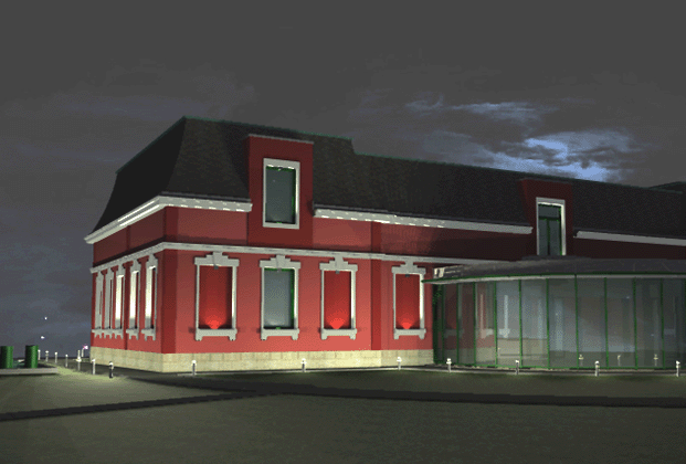

My firts attempt in night rendering in AC. Played with it to make a lights composition study. I was really impressed!
Window covers are an integral part of the Window Object. Look for "Shutter" in Parameters. For special ones you have to model them yourself.
Kliment its really impressive for your first night render in archicad. Wish I knew how to work eds max and Vray to have better quality renderings.You have to tell me some things about it kliment.There is my first attempt on night rendering in archicad 3 years ago with archicad 8.2. I Think it pretty good for first attempt 3 years ago.What do you think people?
Light quality is fine for regular projects. Not photorealistic, but usable in discussions with clients. For competitions or high-profile work, it is not good enough.
Textures are severely limiting the quality and this will not be solved with better rendering engines.
P.S. I'm not claiming to do much better, although I'm sure that I can come up with some decent lighting using VIZ and its latest release of the Mental Ray plugin. VRay is nice, but Mental Ray in VIZ 2008 and 3ds max 9 has considerably matured, regarding architectural lighting and materials.
