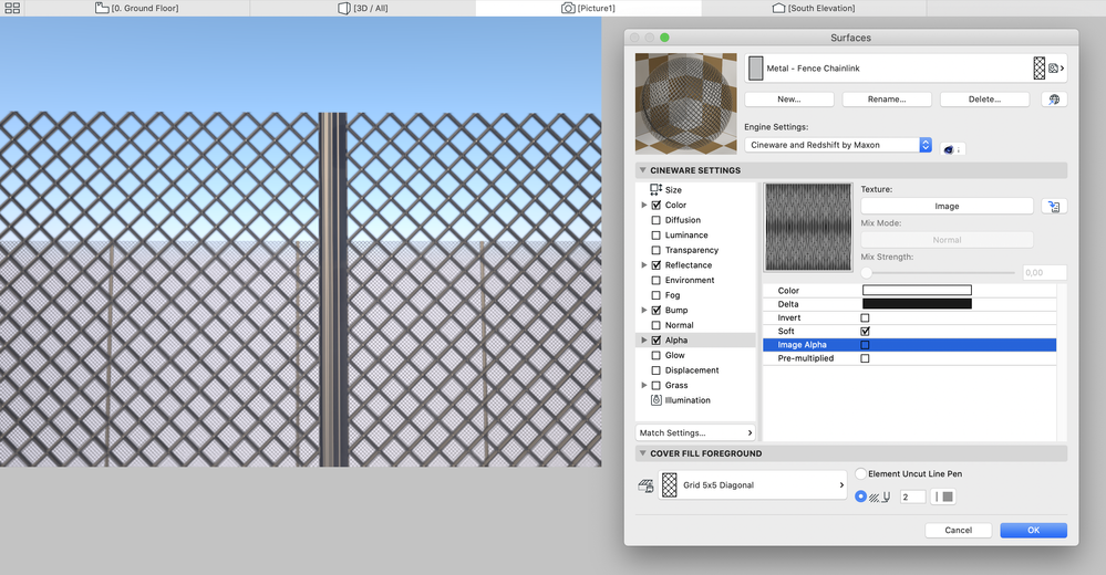

Alpha channel may not work as expected on macOS
To render transparency, it is recommended to turn off Image Alpha option.

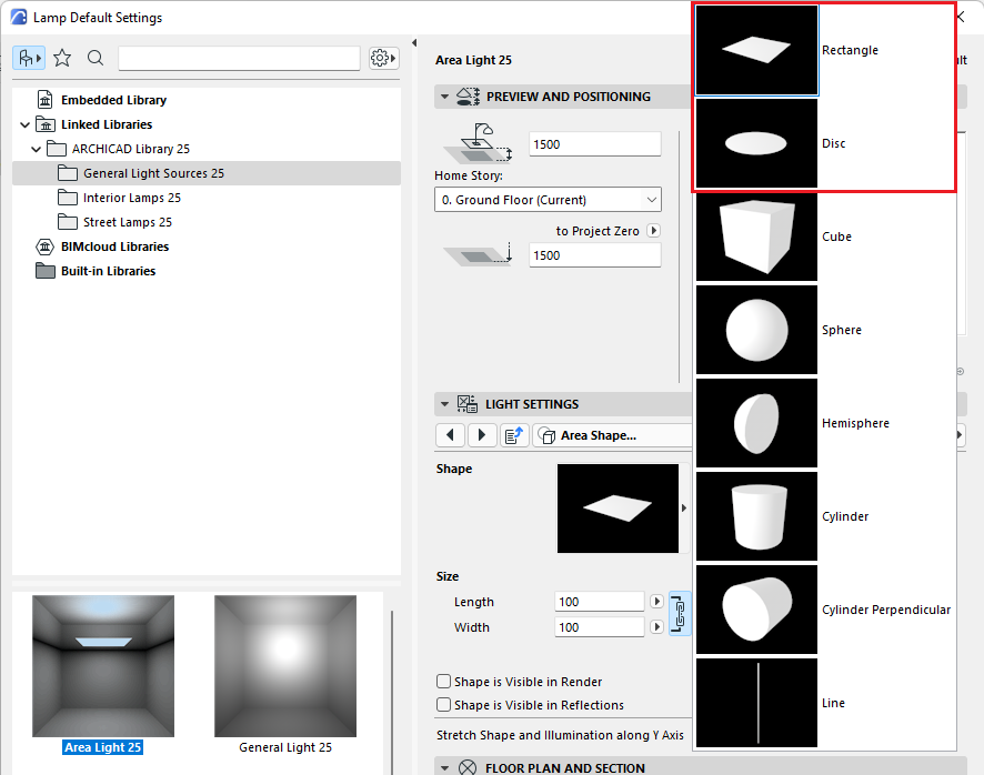

II. Light Sources and Objects
Area Light: it only works with Rectangle and Disc shapes in Redshift
Redshift cannot render other shapes, or the light cannot illuminate

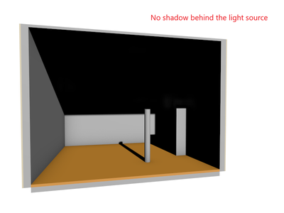

Parallel Light: there is no shadow behind the light source in Redshift
Cinerender
Redshift

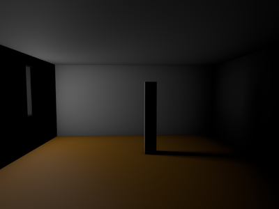

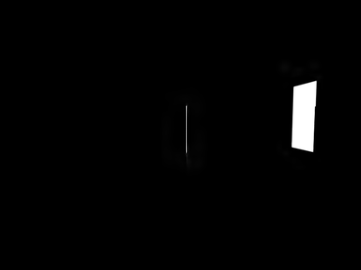

Window Light: the light source does not illuminate nearby surfaces without Global Illumination, or becomes too bright.
Cinerender
Redshift

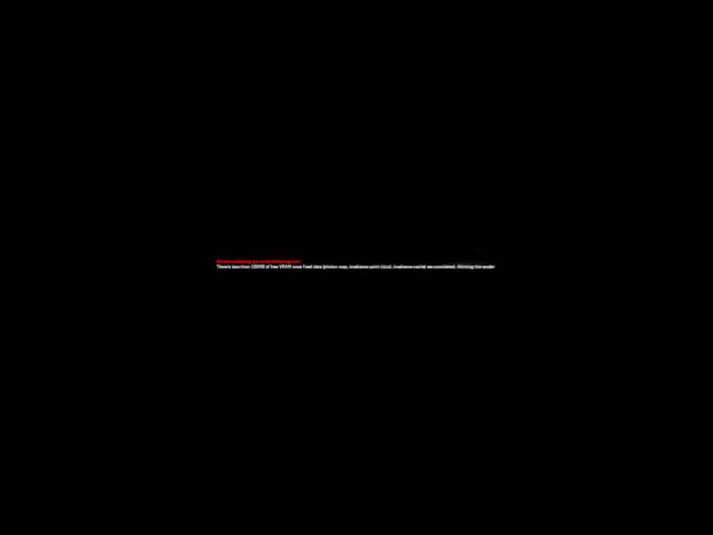

pdimova
I have the same problem. Full black screen on one of the computers I use. And a Warning! "Your hardware configuration does not support Redshift by Maxon" on my laptop.
Does anyone know what are the minimal spec requirements for Redshift?

proev
I get the same black window with an error message that is so difficult to read, even when I saved the render I zoomed it wasn't big of a help. However there is a part in the message that says 128MB and when I looked at my graphic cards, it's the dedicated GPU memory of the Intel processor internal graphics. Somehow Redshift is trying to use the onboard graphics and is unaware of the existence of my second Nvidia GPU. And I think I'm right because finally I succeeded in rendering very small frame of just 320x240 pixels, 480x360 also but when its up to 640x480 I get error again(18-05) r.12t - Picture1 (2).jpg320x240.png640x480.png
Minh Nguyen
Graphisoft Alumni
Graphisoft Alumni
Hello,
If you have an Nvidia GPU and an integrated Intel GPU, it might be the case that the Nvidia Optimus kicks in to save power in certain situations. You may want to take a look at this article about how to force an application to run with the dedicated GPU.

Lukas Zeleny
Someone has a similar problem as me? I don´t see any error message, only black screen.

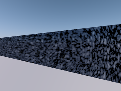

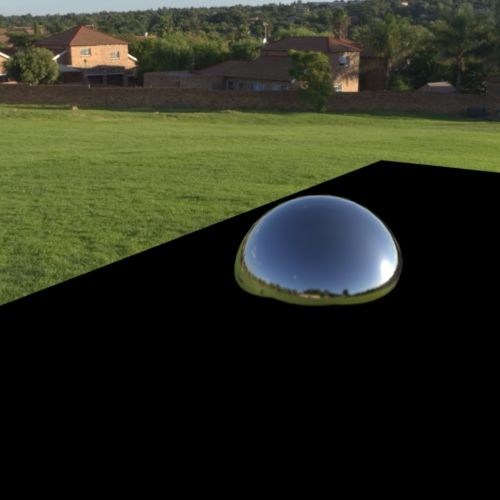

Karl Wir_n
From the text above:
  • Redshift's render with HDRi sky might be darker than Cinerender's. Additional sunlight should be used in this case.
I found that the checkbox "Sky Visibility"  is causing this. If you uncheck it, things work better. See my examples. First with Sky Visibility , than two pictures without:
Sky Visibility checkedSky Visibility checkedSky Visibility uncheckedSky Visibility uncheckedSky Visibility unchecked, Different HDRISky Visibility unchecked, Different HDRI
Karl Wir_n
Just to clarify my post with the pictures above. It seems that leaving Sky Visibility checked doesn't affect reflectance, only the color channel. The slab that the sphere rests upon is completely black in the first picture. On the other pictures the background becomes completely black, since Sky Visibility is unchecked, but the slab is now correctly lit.
