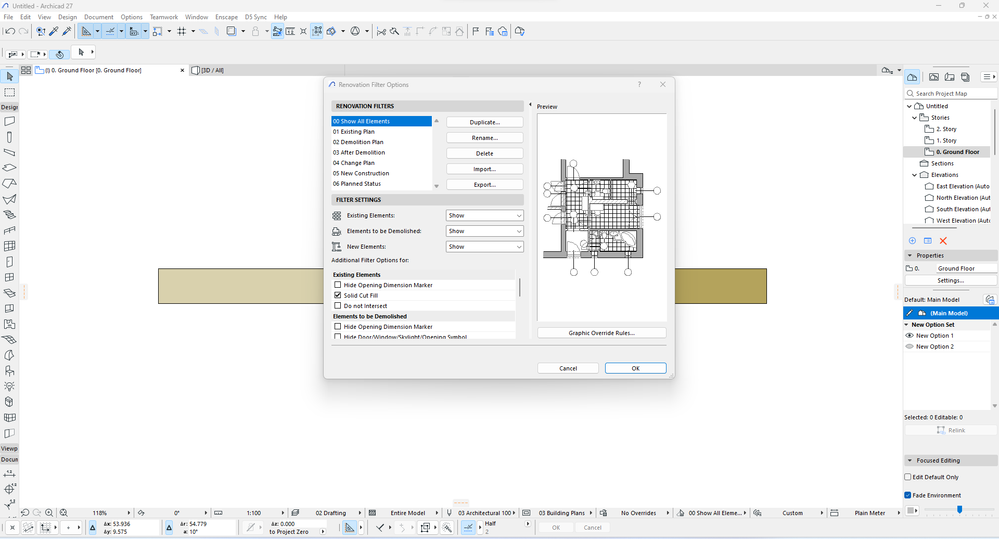

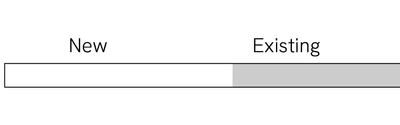

I have a wall that is next to a wall with a different cut fill (it is an extension of an existing wall, into a new wall).
Is there a way for a line to show in between the old and the new?
1 ACCEPTED SOLUTION
Solution
Lee Hankins
If the walls are identified truly as new and existing using the renovation filters you can select the option within the renovation filter settings that new and existing elements do not intersect. You will then get a hard line between the new and existing wall.

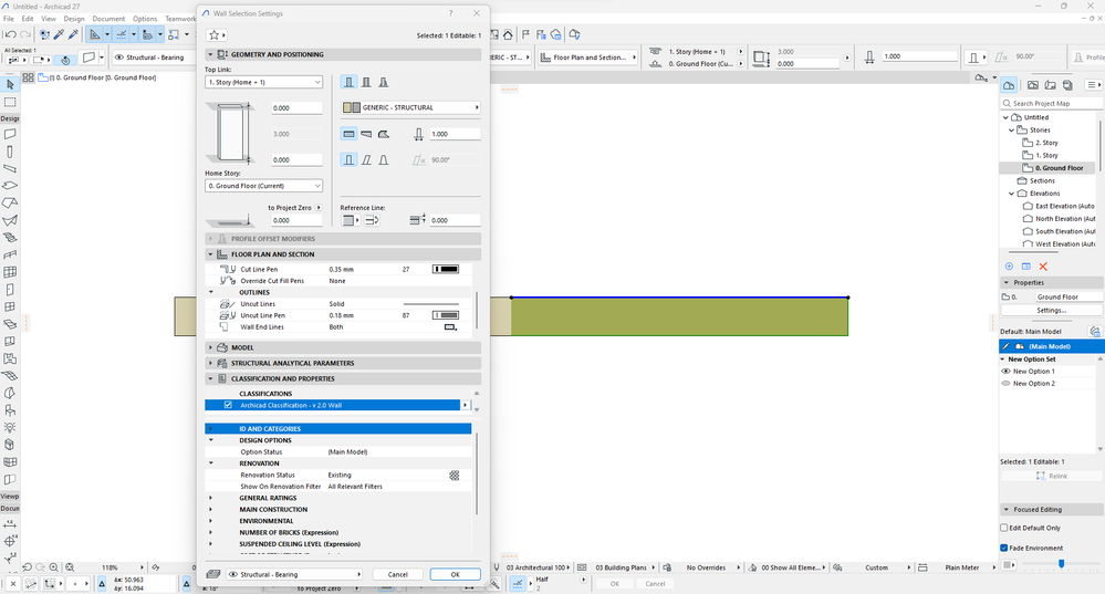

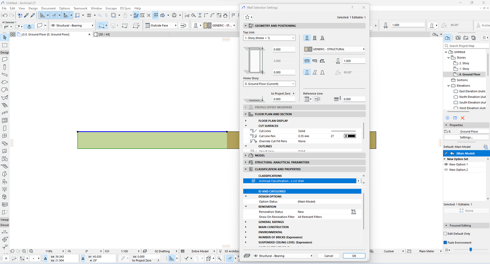

I can't produce this result as @Lee Hankins described so if anyone can approve that it's working?
These are my settings:
Screenshot 2023-11-02 110134.pngScreenshot 2023-11-02 110152.pngScreenshot 2023-11-02 110228.pngScreenshot 2023-11-02 110325.pngScreenshot 2023-11-02 110502.png
