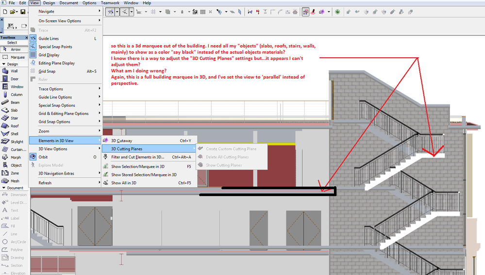

this came up once before when I was using AC14 but not in AC17...is it different?
I can't seem to get to the dialogue box that allows me to adjust the color of the section cut.

Go to the next command down: Filter & Cut Elements in 3D.
Adjust the Cut Surface Display.
