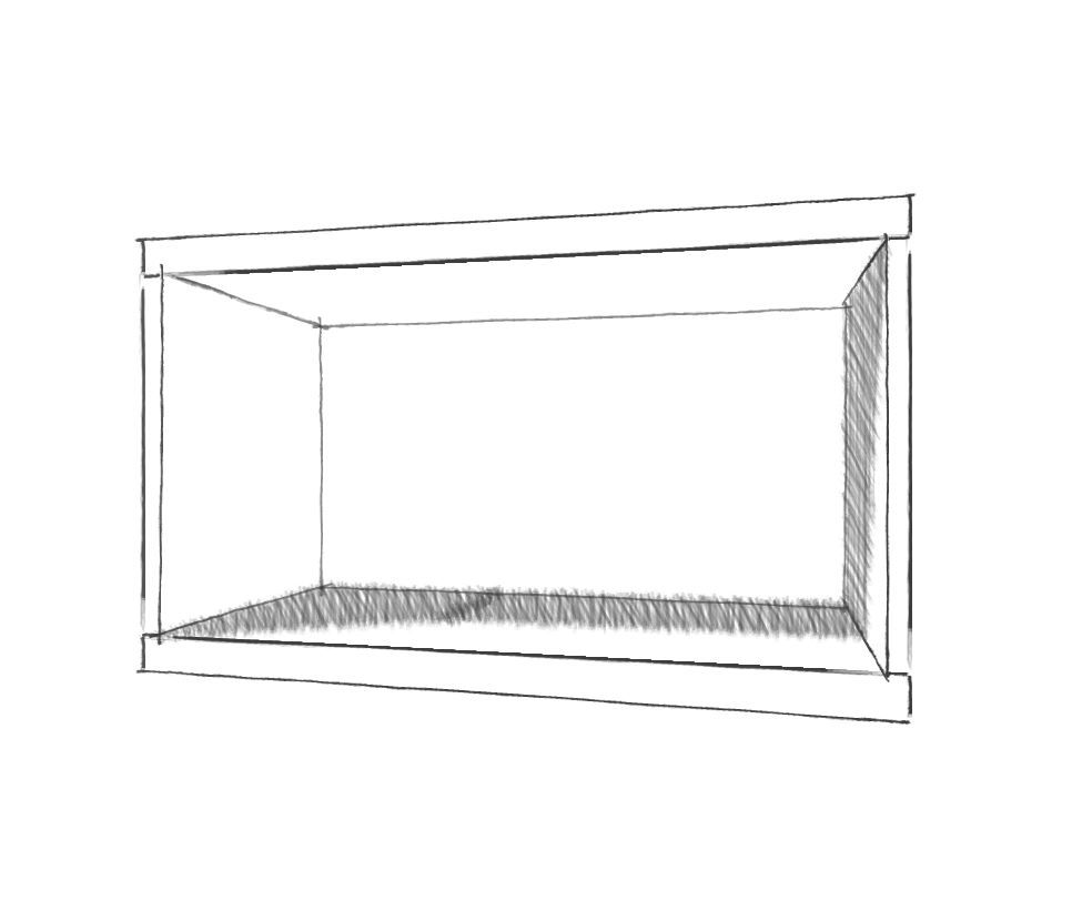

I have been trying to learn how to use the ArchiCAD sketch rendering engine. I have found that the sketch engine will tend to not shade the horizontal surfaces like underside of floors or ceilings. I find this looks strange when casting shadows on walls and floors but the ceiling is bright white.
Please see attached image.
Any ideas where I may have gone wrong.

In the sketch render engine, showing vectoral sun shadows only enables cast shadows, not shading of surfaces.
To disguise the deficiency, give your vertical surfaces a little texture, not plain white.
You might consider instead a proper 3D solid line view with cast vectoral shadows jiggled a little in Photoshop - this tends to be more inclusive of the effects ArchiCAD can generate.

depending by kind of sketch you want .
for a more expressive one you must set all the materials to have
vectorial hatch associated in the material individual propriety (wood , roof,..etc )
I use the photoshop method too, it can be pretty handy having various layers of sketch or other renderings ( thin lines, thick lines, with and without shadow) above each other, and mixing these together to become the right picture...
The only thing I can't seem to find is a way to render a solid line view without textures, and with or without cast shadows... ( becoming another seperate layer with only the shadow casting, which can be applied as wished )
