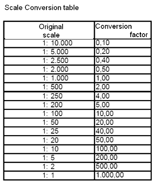

Publish or save the correctly resized and scaled Drawings to dwg or dxf formats. In the DXF-DWG Translation Setup dialog (File/File Special) you can add the export/import options like Pens and Colors, Penweights or Line types.(You'll recognize that everything is broken down into the most primitive elements (lines, arcs, hotspots). This is necessary in order to see them later in 3D.) Be very careful about Drawing unit at this save operation, the following chart contains the needed conversation values.

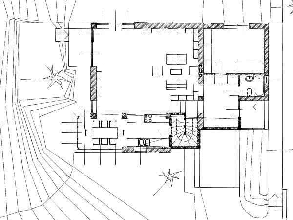

Select the Object. Go to the 3D Projection Settings dialog box. The below picture shows how the Object will look in 3D in isometric projection. You should select Top View so it will look like a 2D view in the 3D Window. Go to the PhotoRendering Settings dialog box. Select the Sketch Rendering Engine and click the Options... button to enter its Subdialog where you can select and customize the kind of Sketch Rendering you want to apply. Also, set the desired PhotoRendering size and background colors for your Rendering. You may also find the file " SketchPreset .txt" located in the "Add-Ons / Visualisation / Sketch Textures" folder. You can copy and paste a whole Preset into another portion of the file and modify it to your preferences or save in it a Sketch setting set that proved great-looking for you. Make sure to create a copy of this file before you start modifying it. Here are some final sketch results from a Floor Plan of another Project:
