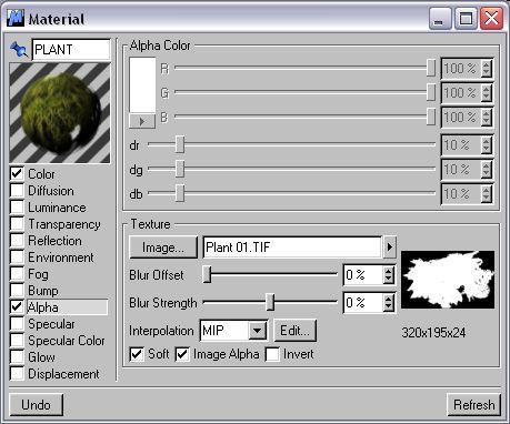

Can you rephrase your question?
You mean billboards: in Cinema4D they can be made by creating a plane, making a material using alpha-mapped pictures.

stefan
Addition: I also applied the same picture into the Color channel and disabled the Specular channel.
You might assign it into the Luminance channel to prevent the material being influenced by lighting if you want.
