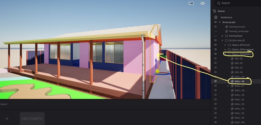

hey everyone,
is there a way to render a model from 3d in archicad to twinmotion but rendering each individual surface face of an object as opposed to rendering each object based off being a layer or element
thanks
1 REPLY 1
Carstenem
Hi yes you can but you need to import to TM as keep hierarchy. If you do this you can see in the scene graph that TM creates folders with each individual walls, slabs, etc. as example.
Some screen shoot for explanation.
Cheers Carsten
