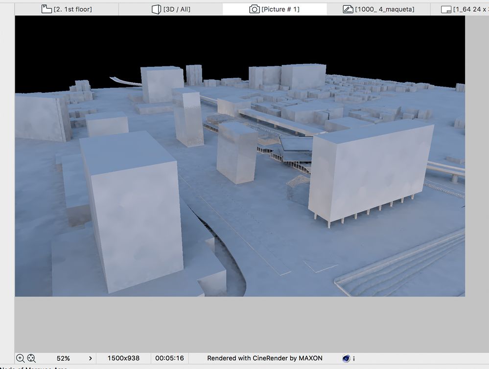

Everytime I Render a view it starts calculating the cgi and then it gets stuck at preparing 5.6%, eventually it says its finished but its not. When I open up render settings again I get the following error message
"Warning, cine render by maxon add on has unexpectedly close Archicad should be restarted. "
p.d. It happens with the custom rendering scene I have been using for the past year and also archicads default render scenes
I can't render at all, the preview comes out in the render settings window but the actual image does not. I tried Marquee with several areas of the project but still no luck.
iMac - MacOs Big Sur 11.6.6
Archicad 24 - Latest Build
Archicad 25 - Latest Build

Jan's problem was fixed by unchecking the Grass Setting in C4D.
He was using a preset that had it on and since he had an area about a mile long with grass C4D was hanging while processing all of those grass blades.

I think this problem should either come down to
- the RAM not being enough (the model is too detailed), so try to render a much smaller area first, and see if that helps.
- or a known issue with cinerender in general. You can read more about it here.

Have you tried Daniel's suggestion: render a small area first (use marquee tool in 3D to mark out a small area) to rule out if it is caused by running out of memory due to too complex model.
The original poster problem was due to having the 'grass' effect on for a very large size terrain, for example, which will cause memory issues.
