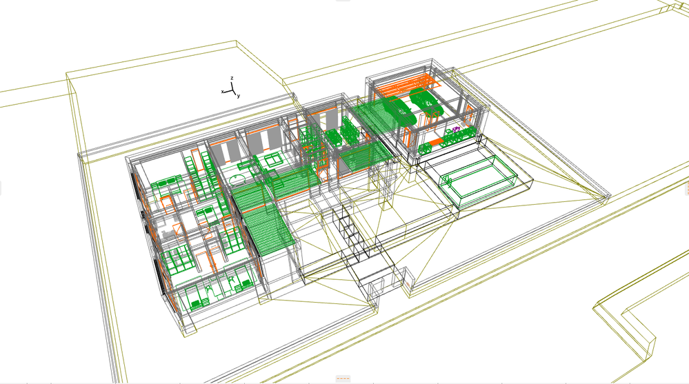

I've recently started a work on my new archicad 26.
On the 3D view suddenly the visualization of the model changed into a sort of wire frame model even though the 3D style is set in a different way.
It seems the model is all transparent as you can see in the images attached and nothing happen when I change the style.

Are your layers all set to wire frame by any chance?
Solution
ARCH_FONTANA
Thank you so much @Barry Kelly the issue was around the layers. I didn't know it was set as "show zones as 3d solid".
Thanks a lot!
