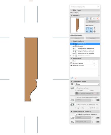

Here is a simple example of what could be done in a project with "free choice material" :
This profile is quite common in traditional interior design and it has just one shape. (one material)
Here it's made of the material : "interior massive wood".
Imagine that in one projet I use this profile in several rooms and I want it to be oak wood in the first room, pine wood in the second, painted wood in some other place, and even gyps or polished stone etc.
Now I don't have this possibility with just one profile. Sure, It's possible to copy as many time as I need this profile and change the material, that makes very long list of attributes for just one setting changed. I prefer not do that.
If I create a "custom material" in my attribute list, (what I do now) I can change it but it will be the same in all the project. The only way to change it separatly is to force the surface in the element settings, that will make 2 problems: 1/ It will not change the hatches in sections. 2/ It will not count correctly the quantity of specific woods or materials.
The existence of "free choice material" could give me all the possibilities explained above without creating many copies of the profile.

I understand what you are wanting to do, but it makes no real sense.
You are saying you want to place a 'generic' material moulding.
Some you will want to be timber, some stone and some render maybe.
So you want to select individually placed mouldings and change them.
That is fine, but you now have to control every individual moulding separately.
By duplicating the profile, you can place timber, stone or render mouldings exactly where you need them.
They are exactly what you want them to be, and you don't have to individually set them.
Should you need to change an individual moulding, you just swap the profile.
Should you ever need to change all of them, you just edit the appropriate profile.
Setting them individually in the element, means you have to edit them individually in the element.
