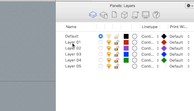

At a minimum Folders NEED to be hierarchical and should display as every folder structure in AC or CAD program
  1. For Example:
      1. A Rhino upgrade only costs $500US around every 14-16 months so it should not be a money issue.
    2. This is what we got

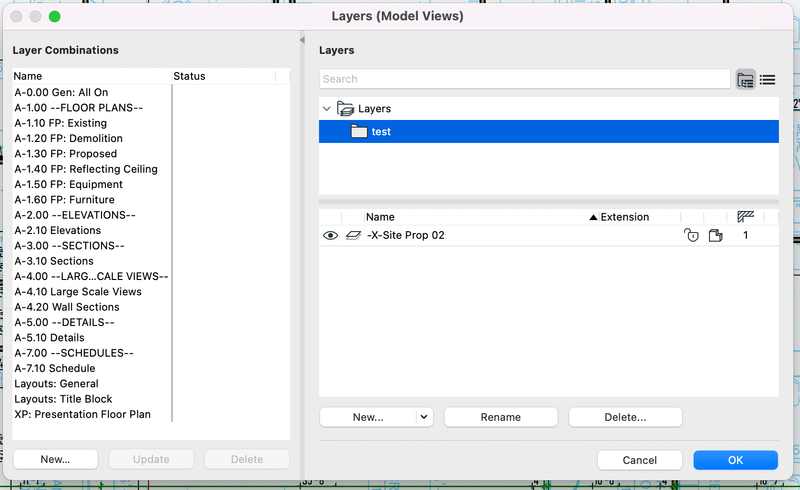

  2. Missing options:
    1. Using Folders to control visibility, priority, lock, properties? . Main problem with this is that a layer can only reside within one folder so this has to be implemented in the Layer Combination side.
    2. Click to rename Layers needs to return

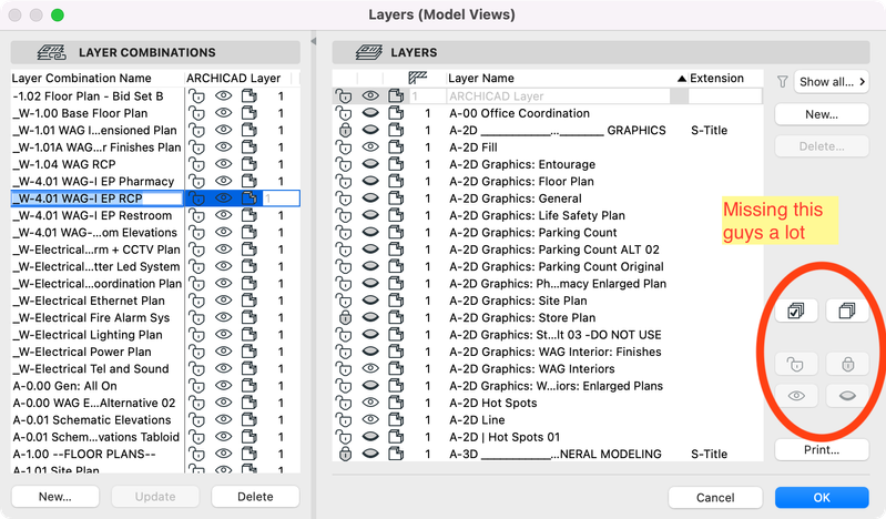

      2. Select All - Unselect All, Lock - Unlock, Hide - Show buttons need to come back.

It was said many times in the Beta that for attributes we should have complete hierarchical folder views, NOT this horrible display of folders with sub-folders in a separate box which doesn't work. Why are GS trying to reinvent the wheel? Trying to manage layer setting for a combo using folders is a complete pain with the current arrangement, it means things are no better than AC25 as you still have to use the list view. Implement the hierarchical view properly and you could do away with the list and implement parent folder visibility control.
And my own beta reported & ignored frustration... WHY has the visibility icon moved to the left of the name? It is no more important than the three other setting which still reside to the right of the layer name.
