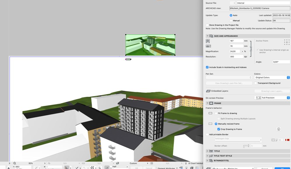

● Right now I have to do screenshot from 3D view and put in drawings layout because quality is much better to take a screenshot from 3D View ( This is a real pain to do all the time ! ) And do it again and again with any new change.
What is this quality ? I can  see how bad is raster of this image 😞 Skärmavbild 2022-05-16 kl. 14.57.14.jpg

Barry this is render. How I wrote I don't wanna render every 3D View.
- I have 10-20 alternatives and I moving windows, balconies and other object.
- I want/wish it just publish in 3D view with good quality at least what I can see on my screen or better.
export 3D view on layout change quality of imagy so bad 😕
Size of pepper is not relevant for this case. I'm not printing it.
I'm showing this alternatives on screen / teams meeting etc. / PDF.
I'm using layout for presentation and for sending to my client. They just want to see or zoom on 3D perspektiv.
