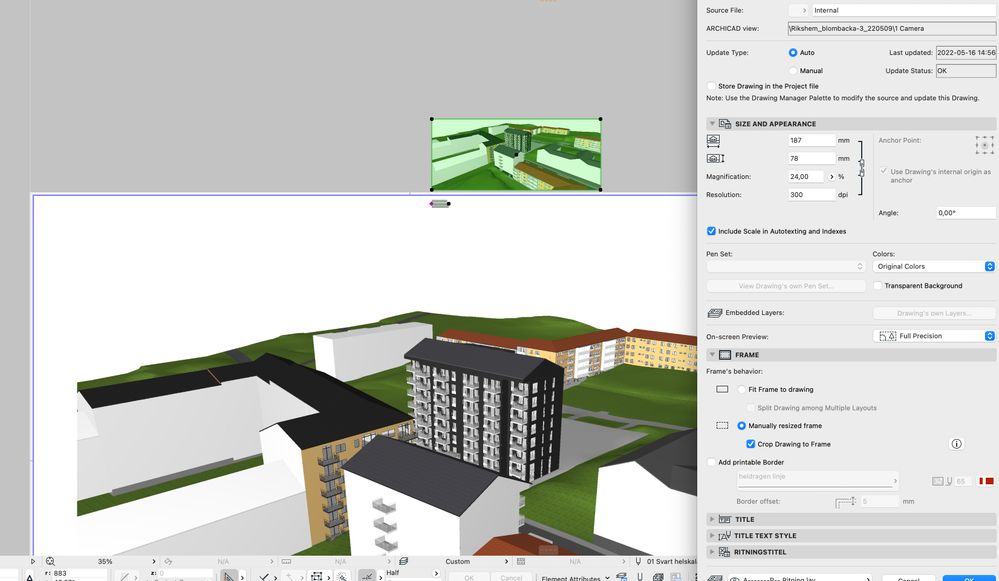

- I wish to have possibility to save 3D view in Good quality (300DPI) for 4k Monitor
- I don't wanna have this image resolution on 2022.
- I'm doing on daily base so many alternatives and so many changes and I need to show without rendering or exporting to another software
- I think everyone will be so happy for this option. 👍

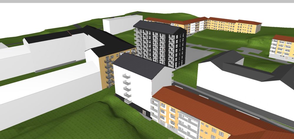

● Right now I have to do screenshot from 3D view and put in drawings layout because quality is much better to take a screenshot from 3D View ( This is a real pain to do all the time ! ) And do it again and again with any new change.
What is this quality ? I can  see how bad is raster of this image 😞 Skärmavbild 2022-05-16 kl. 14.57.14.jpg

I think you don't get my point I don't wanna render I just want to save 3D view with good quality at leas what I can see in preview. ( I wish little bit better )
Because when I save 3D view on layout the quality drop down.
I can do render but this is not case for rendering.
How I wrote " without using render software / render / exporting to another software "
I have 10-20 alternatives and I want to present fast with some quality of image. not this rasterized image what I get from Archicad.
