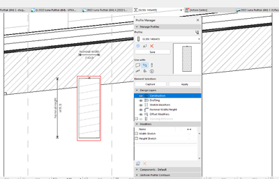

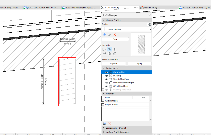

Editing Complex profile with "Trace as Reference"
"Trace as Reference" drawing when editing Complex profile, so section or another active drawing will be shown in background of Complex profile editor. This way you can easily adjust complex profile to fit to drawing. Drawing must be placed in same position as it was in active plan/section/façade view, so you will have feeling that you editing complex profile in project not in separate editing space.
