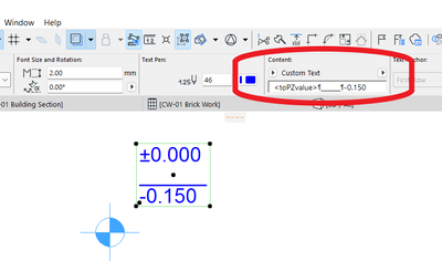

If you are OK with such display then try to edit the dimension text by setting it as "Custom Text" with Enter key to change the text line and then using several "Underscore" key strokes for getting divider line and again enter key to change text line to type another level dimension value.

@Rajesh Patil This is interesting, but not what I want to achieve.
As for the symbol, I would like it to display as shown in my first image.
As for the heights, I would like to not put "custom height", but to subtract the core thickness for the core top height automatically.

In such case try using Label Tool as you can add any property defined under Classification & Properties topic. Also you can design your own Label for its appearance too.
