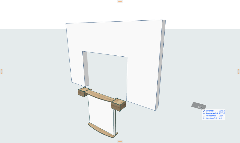

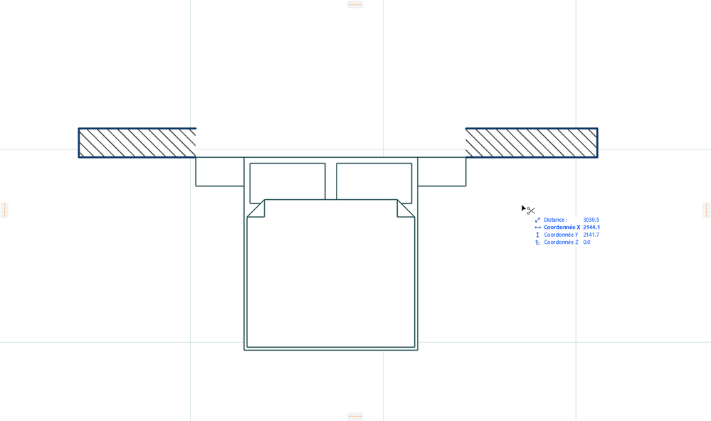

What if some objects from the library behave like a window, they can be anchored to a wall, when the wall moves, they follow on,
here i changed the type of a bed inside the GDL editor t oGS-Window, so it appears in the window menu,
Now it can be placed on a wall like a window, but it's turned and it has a Wallhole,
the object keeps all it's parameters it's fully parametric like the original bed
Does someone know how to fix this ?

Anyway: Every door is scripted lying down. Meaning what you think of the Z-axis is actually Y.
You should rotate everything back by using a "rotx 90".
I have found this code in one of the GS objects:
wallniche 3, 1, 2,	! Fake wall cutting body far away from the wall body
0,0,1,	0.01,	        ! to disable cutting wallhole by the Archicad.
0,	  WALL_THICKNESS + 1.01,31,
-0.01,WALL_THICKNESS + 1.00,31,

I got this code to work perfectly in the 3D script. In my case, I tested it with a sanitary artifact converted into a window, but I had to set the rotation factor of the master script to ROTX 270. And to complement the 2D script, I added the same code but changed "wallniche" to "WALLHOLE2". Regards!
Script 2D:
WALLHOLE2 3, 1, 2, ! Fake wall cutting body far away from the wall body

is there a way to hide that black box points and replace them by a centrer point in the buttom middle ?

The hotspots in the wall would be the extents of what would be the opening based on the 'A' & 'B' sizes (width and height of the window/door).
The WALLHOLE you can hide by scripting a very tiny WALLHOLE (not sure if you can have one that is zero in size) or a WALLNICHE that does not cut the wall.
If you script nothing, you will get an automatic WALLHOLE based on the A & B sizes (I think this applies to both the 2D & 3D scripts).
