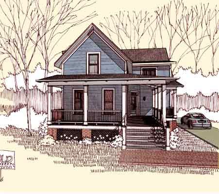

In addition to what others have suggested...
If you want a "flat" elevation, then use a straight on perspective. I do the LW/sketch combined in PS method, which I find very easy and quick, and with nice results. I do one additional step. I print the sketch rendering, (after opening in photoshop and do a bit of erasing where I want bushes), then hand draw the bushes and trees, again, nothing elaborate.. quickness is the key for this:). Then scan it into PS and combine as others have described. This can take about an 1 hour or so. I add the yellowish background so it blends into a web page... and give contrast to foliage. Another thing I like to do, is change the black sketch lines to sepia in PS (colorize command).

Rick,
I've always liked your renderings. Thanks for the step by step. The SOLD sign is a great touch

Thanks
You got to do something to break any seriousness about life:)

/... You got to do something to break any seriousness about life:)
I agree with Erika's comment.
Hope your little flying men are friendly, Rick
The sepia look and that of the old blue print is always easy on the eye.
