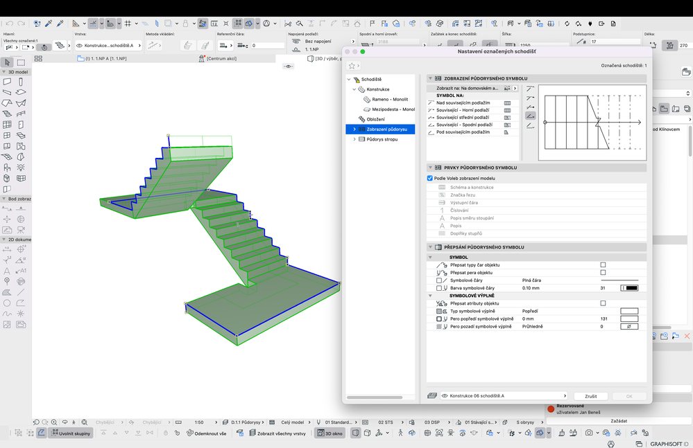

Dear Delevopers,
it's a long time since we have this issue in Archicad. When we set stairs Floor Plan Display Layout in original file, these informations are lost after use these file as a hotlink. It would be nice bake the Floor Plan Display Layout when some file is hotlinked into another file or any other solution which would keep the original Floor Plan Display Layout of stairs.
When you create one project with a lots of hotlinks its really hard make one "clean" floor plan documentation. Using PMK or Views from original file is really painful and time consuming solution.
Best Regards,
Jakub Nohejl

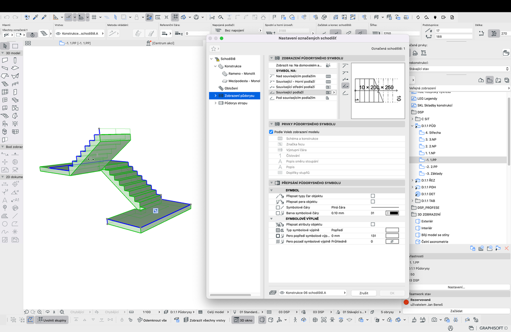

Original Stairs:
OriginalStairsOriginalStairs

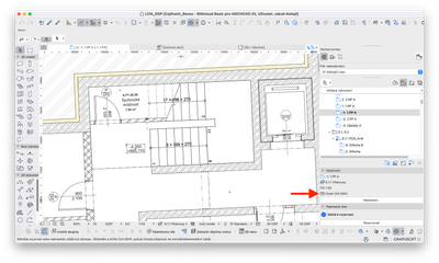

Hotlinked Stairs:
HotlinkedStairsHotlinkedStairs

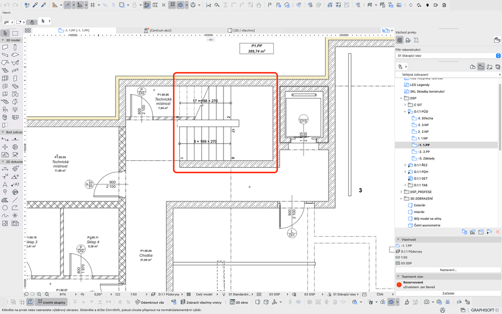

Original File:
OriginalFileOriginalFile
Hotlinked File:
HotlinkedFileHotlinkedFile

JeffH
Based on your screen shots, it looks like you have different model views shown for each.
Under the MVO settings, you can check which options you want to show..this might be the reason perhaps.
AC24 / AC26
Win10
Jakub N
Thx Jeff,
when I set the MVO to the same it look good. Unfortunately, there will be another issue because many of views have the MVO set as "Missing" (in CZE = Chybí)  in coordination file.  
