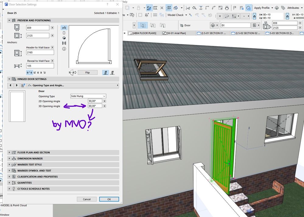

I want to post this New Feature Request for setting the 3D opening angle of Doors, Windows & Skylights in "Model View Options" instead of in the Element Settings.
If we need to Publish 3D models to BIMx & Twinmotion (or other render software) with Doors, Windows & Skylights in open position, we have to actually select all Doors, Windows & Skylights and change the in 3D opening angle in the Element Settings, then Publish. Then we have to change it back (or Undo) so that Section & Elevation drawings are as we need them to be. This is not only tedious but causes disruptions, delays & some times errors with drawings in project files of other team members especially when working in Teamwork.
Request / suggestion:
If these Doors, Windows & Skylights settings are controlled in "Model View Options" we can then globally control 3D opening angle (and perhaps also the 2D opening angle) by MVOs linked to Saved Views. This would make it possible to Publish 3D models to BIMx & Twinmotion (or other render software) with Doors, Windows & Skylights in open position but still have them on closed position for Sections & Elevations. Models appear more life like especially when the doors and in some cases Windows & Skylights are in open position.  This will give us more flexible output workflow for different scenarios.

Agreed.  An issue that needs to be considered is the opening angle of swinging doors and windows is set by degrees, and the opening amount for sliding doors and windows is set by a dimension value.  So the MVO may need two or more settings.  An alternative may be to change the opening amount to a percentage for the sliding units...

Yeah... I recently ran into this issue as we were told to open all of the doors in 3D views... That's a lot of doors in a lot of modules...
Yes - MVO should be reworked so that it contain any and all settings that control how an element is represented in 2D and 3D.
Given this topic and survey from GS there is some work being done on MVO and/or element representation and I guess a opinion given there has a shorter way to target than one going through the wish forum.

I have no problem with object settings being controlled in the MVO.
But we must have a choice.
In the object there should be a setting to use MVO or not.
If set to yes, then it will use the MVO settings.
If set to no, then we need to have those settings available in the object itself.
There should be no problem with this.
The settings are all scripted in the object.
The MVO on/off option just need to hide those object parameters form the user and then use the MVO parameters.

I agree with your very practical suggestions. It is exactly the type of MVO options we have since "forever" on Windows & Doors.
I hope this should be easy for the Dev teams to implement on other objects too.
