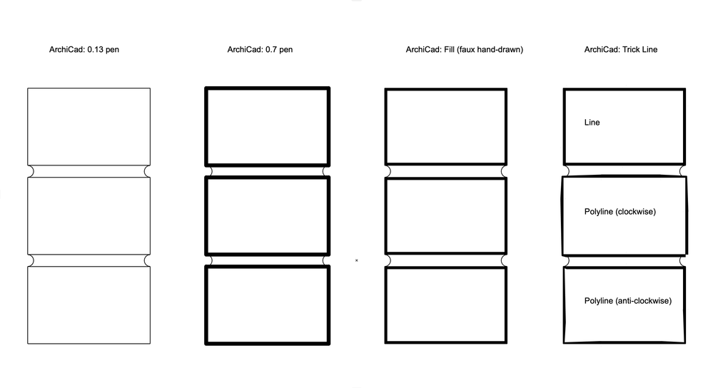

Wishlist: Pen drawn drafting quality.
Guildsman
With old school pen drafting, lines could be thickened to one side: a simple and wonderfully clear graphic technique, especially in sections. Only one programme that I know of has ever emulated this in 2D: the now defunct Micro GDS. If they could do this pre-2013, surely it can't be a difficult code to write? Would love to see it picked up in Archicad: any takers?

You can create a thickened line type that is offset but you need to trick AC.
Create a thicker line with multiple solid lines, then add a tiny offset line, no more than a dot. AC will read the tiny line, no more than a dot, and centre the line accordingly. But when you use it the dot is so small you can’t see it

Thanks for the replies Eric and Tim!
Tim I vaguely recall trying your technique way back in AC12 but think that it came apart when I turned corners: I'll give it another go though and report back!
Here's an image comparing the types: Screenshot 2022-01-23 at 04.10.01.png
