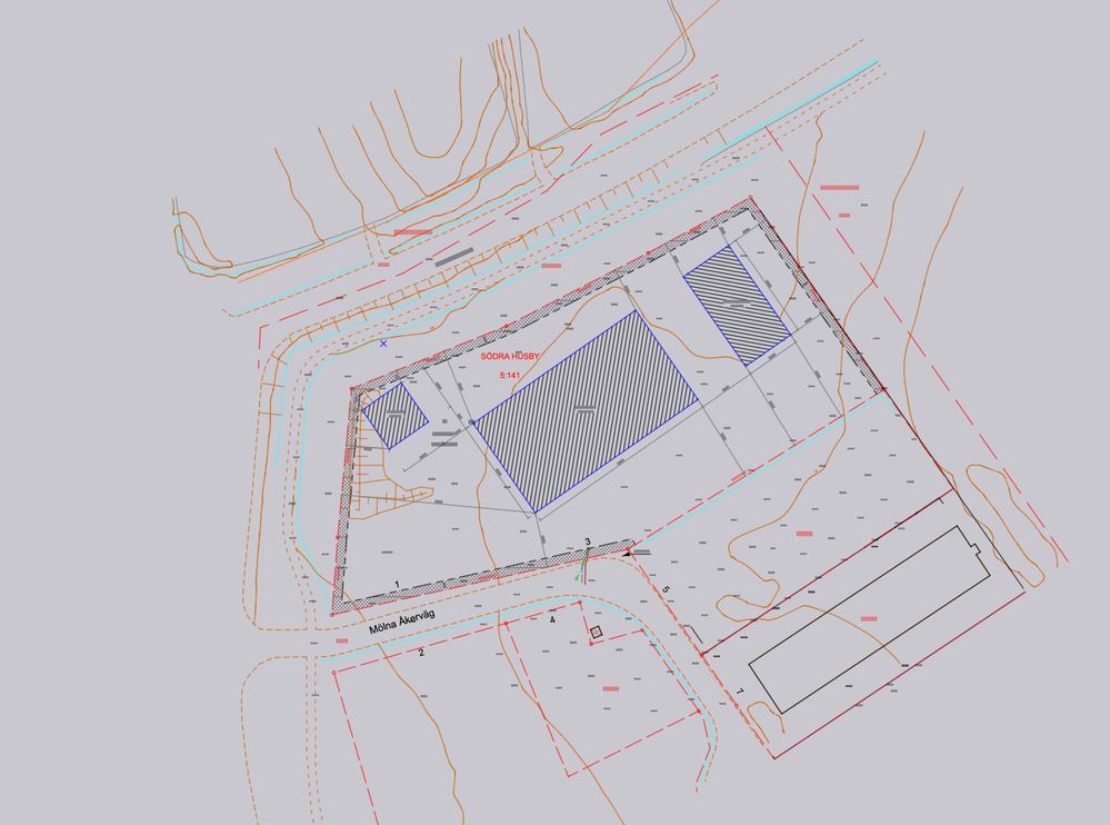

1. I attached XREF to original coordination and then I draw my situations.

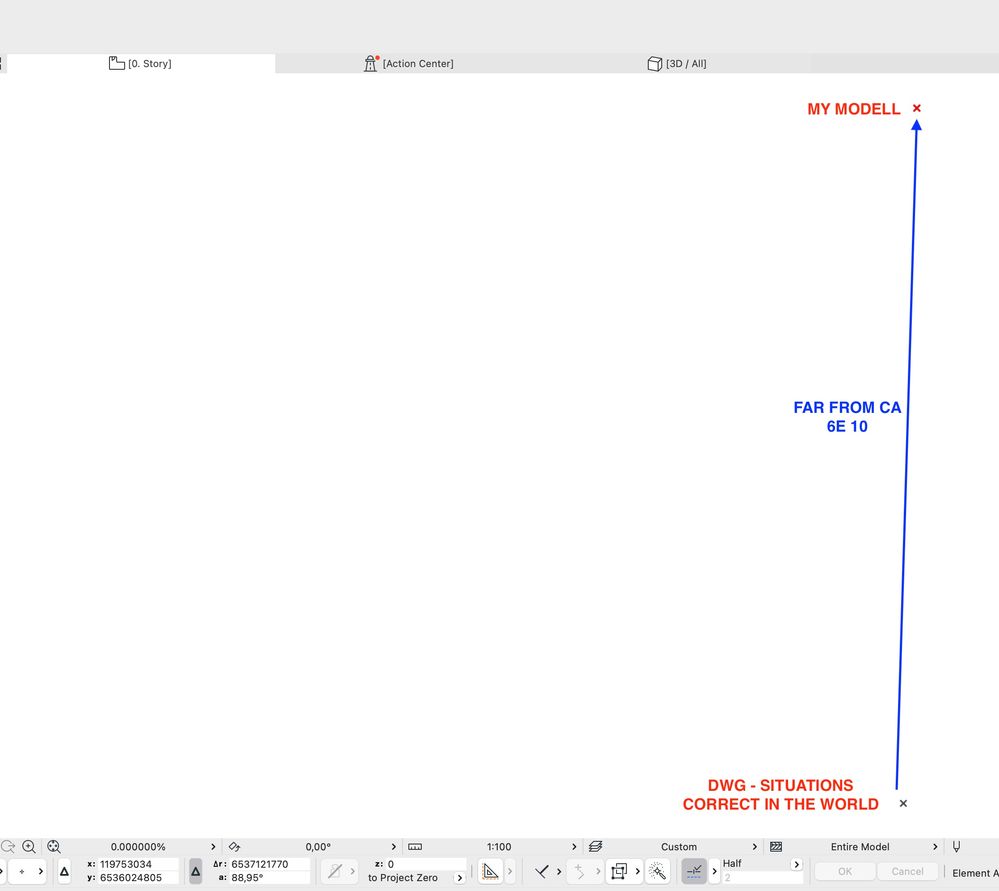

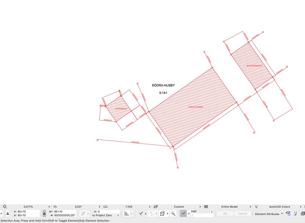

2. After export I can see that XREF is on right place but my drawings is move so much way off
Skärmavbild 2023-10-04 kl. 14.14.48.jpgSkärmavbild 2023-10-04 kl. 14.14.28.jpg

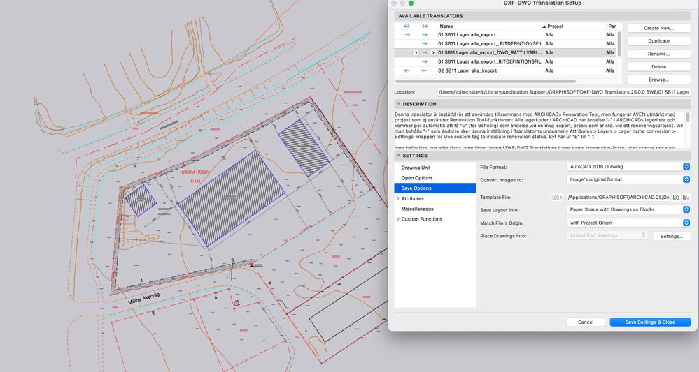

I checked my setting for translator but I don't see anything suspicious why is doing this

You could also try to place a Survey Point and in the DWG Translator's Match File's Origin field, select the with Survey Point option.
