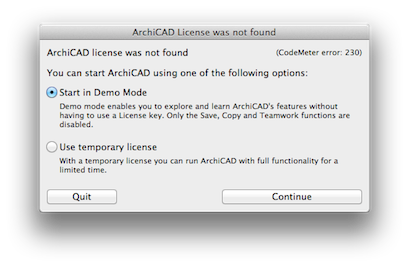

ARCHICAD starts in DEMO mode after updating to 10.9
The update removes a necessary plist file from the Library. Because of the removed plist file,  CodeMeter.app was not launched and prevented AC from running in full mode. The workaround is to uninstall and then reinstall CodeMeter. If a higher version of CodeMeter is installed, the uninstall is not necessary.
ARCHICAD license was not found error message appears after updating to 10.9
ARCHICAD 16 and older versions may give "No WIBU-KEY driver found (501)" error message. To address this problem you need to re-install the Wibu/CodeMeter driver.
  • remove your USB key from the computer
  • you can find the driver on the ARCHICAD installation DVD or you can download the latest GRAPHISOFT tested version from here.
  • run CmInstall.mpkg from the CodeMeter folder of the DVD if you have a silver - CodeMeter key
  • run !WKInstall.mpkg from the WIBU folder of the DVD if you have a green - Wibu key
  • restart the computer after the installation has finished and replace your USB key

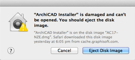

Installer is damaged and can’t be opened
In certain cases OS X will give the following error when you try to mount a GRAPHISOFT provided dmg downloaded from the Internet: <Installer name>.app is damaged and can’t be opened. You should eject the disk image.
This problem can be easily circumvented by setting the Gatekeeper setting to Anywhere. After that the dmg should mount fine. The installers on the installation DVD are not affected, this issue seems to be related only to downloaded packages.
