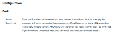

Basic
Server Search List Enter the IP address of the server you want to use a license from. If the list is empty the computer will search accessible licenses on every CodeMeter server in the LAN region (you can specify multiple servers, ARCHICAD will search for free licenses in the order as on the list. If you have more CodeMeter keys, you can divide the computers between those.)

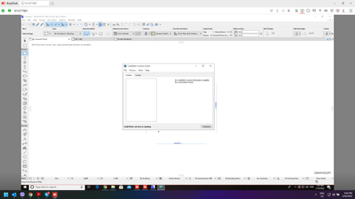

ALBINPEREZ
Hello,
We have client using Archicad 21 Net license hardware key. Client request the instruction of Activation and how to deploy the license from SERVER to USERS using NET LICENSE HARDWARE KEY.
  • The license already activated to server.
  • Question is from server how to deploy the license from user device.
Thank you
As far as I understand it, if the users are part of the same network that the network key is on, then Archicad will automatically search for an available licence.
If that is not working, on each machine running Archicad, go to the Codemeter WebAdmin as shown above.
Go to the Configuration tab > Basic > Server Search List.
Add in the IP address of the server that has the licenses on it.
I think that should do it.
That is all I have done at my office.
ALBINPEREZ
need the same network the SERVER and users?

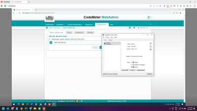

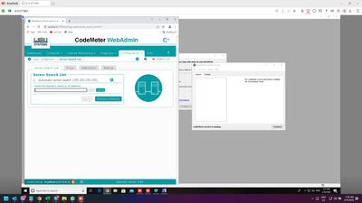

ALBINPEREZ
 --- code meter web admin for SERVER -------
____________________________________________________
  -code meter admin for USER---
Of course, otherwise you could use anyone's license.
The server and users all have to be part of the same network.
If the users are external, they have to connect to the network via VPN.
