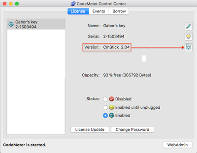

CodeMeter hardware license keys shipped by GRAPHISOFT before 2018 are using KEXT 3G (Kernel Extension) as a default for communication with the CodeMeter Driver. With the release of macOS 10.13, Apple introduced a strict policy where 3rd party USB dev...
wp-content_uploads_2017_10_Warning_18x18.png wp-content_uploads_2018_02_codemeter-runtime-driver-version.png

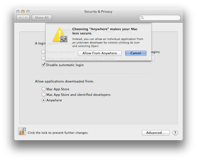

Issue On OS X 10.8 Mountain Lion while running the CodeMeter or Wibu installer an Error message can appear:"CmInstall.mpkg or WkInstall.mpkg can't be opened because it is from an unidentified developer." Cause The installer of the keyplug driver was ...
wp-content_uploads_archicadwiki_bugs-codemeterandwibuinstallernotsigned--1.png wp-content_uploads_archicadwiki_bugs-codemeterandwibuinstallernotsigned--02.png wp-content_uploads_archicadwiki_bugs-codemeterandwibuinstallernotsigned--3.png wp-content_uploads_2016_06_Info_18x18.png
