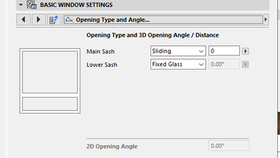

since archicad window object is 1 global object which has all the window types, its hard to pick up these parameters without having to do some manual work on them.

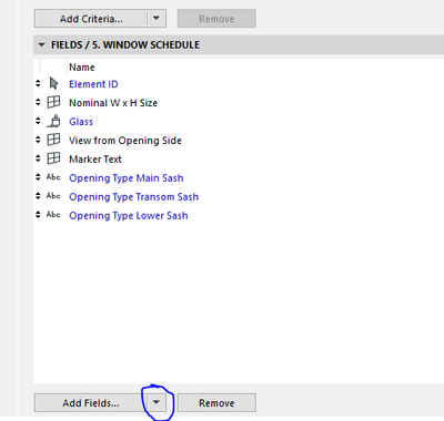

but there is an option to include the sash type in the schedule.
depending on your AC version and which window you are using, you can add the object parameter into the schedule.
click on the drop down arrow and then select the library part parameter. look for the type of window you are using which in this case is the basic window and look for the opening type main sash. this way its automated but you cant change the name of the type (eg. in australia we use the word "awning" instead of "top hung", thats why i dont use this feature.

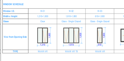

alternatively, what is use is just custom type in order to put the code of the window instead of the type. and to show a 3d view in the table instead of words.
but yeah you can do all sort of scheduling with archicad it just depends on your preference and what you want to show.
