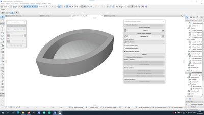

Hi, it's not so difficult with the Shell Tool.
First in plan view draw your plan shape and the section curve you want with lines, circles or polylines. Refer to example below for Element to consider that will define your Shell.
 Set the Shell Tool geometrical Option to by Revolution and the detailed input method.
Then magic wand the curve section to define it and clic the 2 points that define the rotation axis.
The result in 3D, sections C, 1 and plan for my example is as below.
 You now have to define the Shell contour.
 And the final result:

Hi, it's difficult to curve that type of morph afterward, you shoud better use Bolean operations.
Restart from your object, convert it to Morph, then use curved walls for example that matcht the curves you want to follow. Make them higth and thick enought to cover all unwanted part. Substract the resulting walls from your Morph with Solid Element Operation. Finally convert the resulr another time to Morph. You can now delete the walls.
You can realy try to create it with the Shell tool, it's not so difficult.
Advantage wood be ability to connect Shell with other Element like Walls and to apply a composite to a Shell.

You can freely rotate a Shell in 3D.
But to create the type of Shell you need see my second answer.
In your image the Shell you create is an Extrusion, you need to create one by Revolution.
You choose the type in the geometrical options of the Tool.
The simplest way to create the curves you need for your Shell is to draw them with circles or polyline in the plan view (see my second answer). The magic Wand (space bar + clic) on the curve will define it for the Shell.

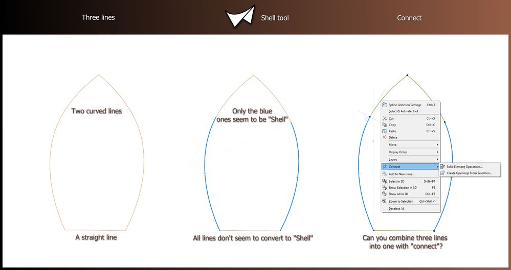

Equinoctial
Regarding the 2nd post, I failed as I make the model from more than one line.
Equinoctial
I keep trying.
I can make a "polyline" with only one line, so I don't have to put them together as I asked in the last post.
Nothing seems to happen when I try to make "Magic wand"/to shell on my polyline (nothing visible in 3D).
And if I draw in 3D with shell it often disappears when I´m done and do/press something else.
