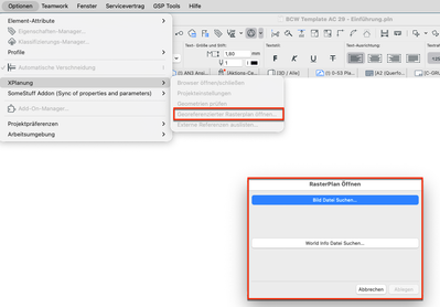

you could hijack the german Xplanung Addon (if available for you). In Optionen/Georeferenzierten Rasterplan" öffnen" you can import a georeferenced orthofoto with its world info file (not sure about the supported file formats though).

It works, but there are two drawbacks I see:
  1. We need a world file. That is not really a problem, it's 6 lines and easy to produce. But it still would be nicer if we could just read the data that's already in the Tif file. That's why we get those in the first place. One could argue on the contrary that at least in this way you can use any file, not only GeoTifs.
  2. The survey point is not taken into consideration. So now we deal with real world coordinates again, which is not nice.

I imported into QGIS, exported the JPG and its world file, and could import that via the XPlanung AddOn into ArchiCAD — it did "georeferenzieren", but it landed somewhat off from where my 2D and 3D data (Der 2D-Innenstadtplan – Berlin.de, Das 3D-Modell – Berlin.de) actually matched up.
It's not that important in the end — this is getting a bit complicated for what I need. I'll just use the 2D and 3D data in ArchiCAD (those two need to match precisely with each other) and manually import the orthophoto separately, placing and scaling it by eye onto the right spot.
