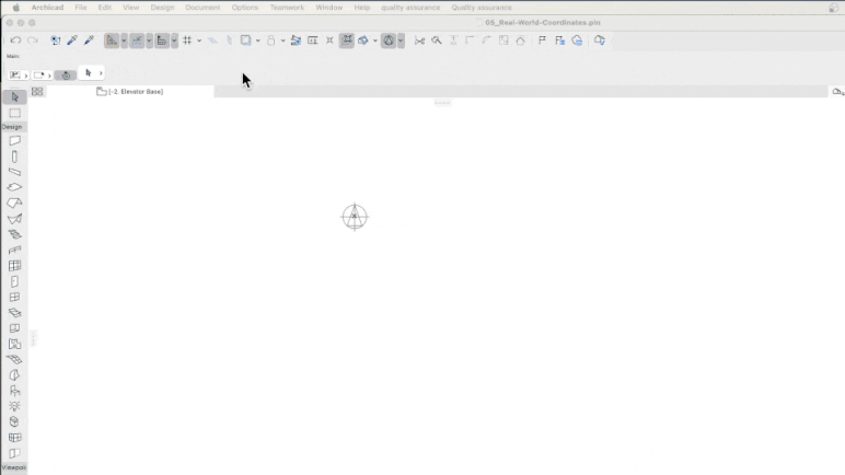

The Survey Point provides a real-world reference within the Archicad model. Initially hidden, it can be visible and easily customized through the Location Settings, accessed by menu Options > Project Preferences > Location Settings. X, Y, and Z coordinates, as well as Project North, should be adjusted. This means the project will remain close to the Archicad origin while the Survey Point position will deal with the real-world coordinates at the export stage.
When exporting the IFC model, the Survey Point can be selected in the IFC translator settings (File > Interoperability > IFC > IFC Translators) to define the IFC model position. This will allow the user to model the project close to the Archicad origin while still exporting it in real-world coordinates. Similarly, the Survey Point can be used as a reference when exporting DWG and working with BCF files.
