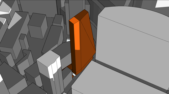

Sun Study on building mass at summer solstice (21 June 2025, 12:00 PM)Sun Study on building mass at summer solstice (21 June 2025, 12:00 PM) Sun Study on building mass at winter solstice (21 December 2025, 12:00 PM)Sun Study on building mass at winter solstice (21 December 2025, 12:00 PM)

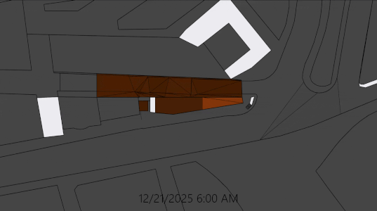

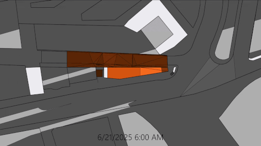

Top view with true orientation, 21 June 2025Top view with true orientation, 21 June 2025
Top view with true orientation, 21 December 2025Top view with true orientation, 21 December 2025

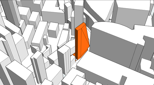

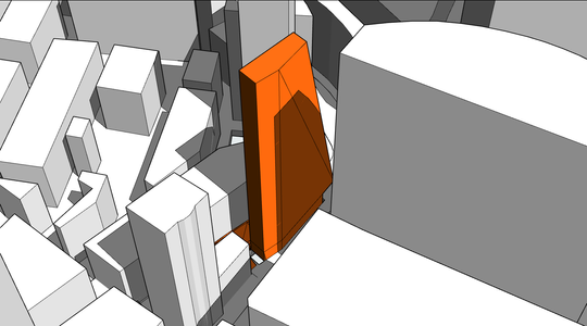

  • The built environment elements do not need architectural detail. What matters is their mass, height, and position. Using simple tools such as Morphs allows you to quickly represent these volumes without affecting model complexity.
Mass of the tower and the built surroundingsMass of the tower and the built surroundings

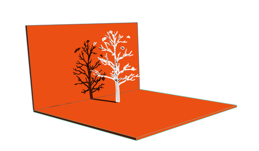

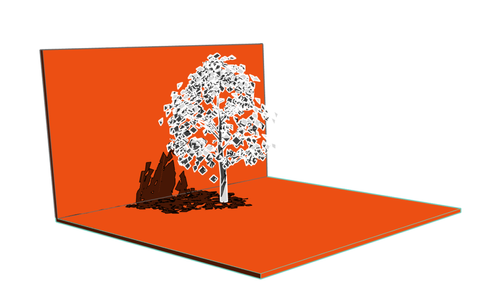

  • When you include trees in a Sun Study, make sure the size, type, and leaf density of the tree objects you use from the library reasonably match the real trees on site and the season you want to represent.
Sun Study on tree at summer solstice (21 June 2025, 12:00 PM)Sun Study on tree at summer solstice (21 June 2025, 12:00 PM)
Sun Study on tree at winter solstice (21 December 2025, 12:00 PM)Sun Study on tree at winter solstice (21 December 2025, 12:00 PM)

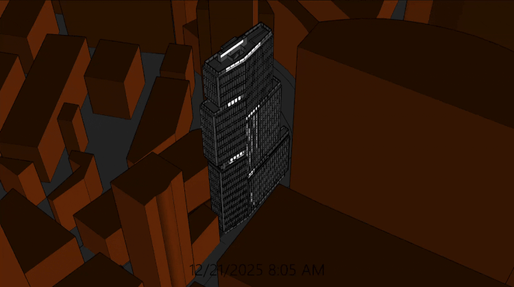

Winter scenario: low sun orbit
A winter day reveals whether:
  • Interior spaces receive enough direct sunlight
  • Low sun angles penetrate deeply or are fully blocked
  • Shading elements or surroundings unintentionally obstruct winter sun
This is especially relevant for living spaces, classrooms, or offices where winter sunlight contributes to visual and thermal comfort or to minimize energy consumption for heating. Understanding sun behavior in this case is also crucial when aiming for a passive building design.

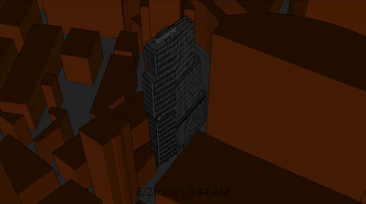

Sun Study throughout the day on 21 December 2025Sun Study throughout the day on 21 December 2025
Summer scenario: high sun angle and long exposure
A summer day helps evaluate:
  • Risk of overexposure on facades and glazing
  • Whether shading devices effectively block high-angle sun
  • Prolonged solar exposure on outdoor spaces
This scenario often drives decisions about horizontal shading depth and facade articulation.
Sun Study throughout the day on 21 June 2025Sun Study throughout the day on 21 June 2025

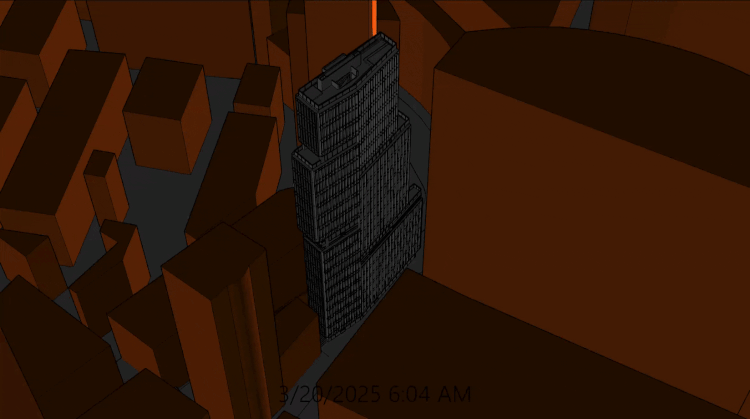

Spring / Autumn scenario: lower angle, longer exposure
Spring and autumn conditions combine relatively low sun angles and long exposure durations. This can result in higher heat gains than expected, especially on east and west facades.
Studying these days supports:
  • Window size adjustments
  • Selective shading strategies
  • Facade orientation
Sun Study throughout the day on 20 March 2025Sun Study throughout the day on 20 March 2025
