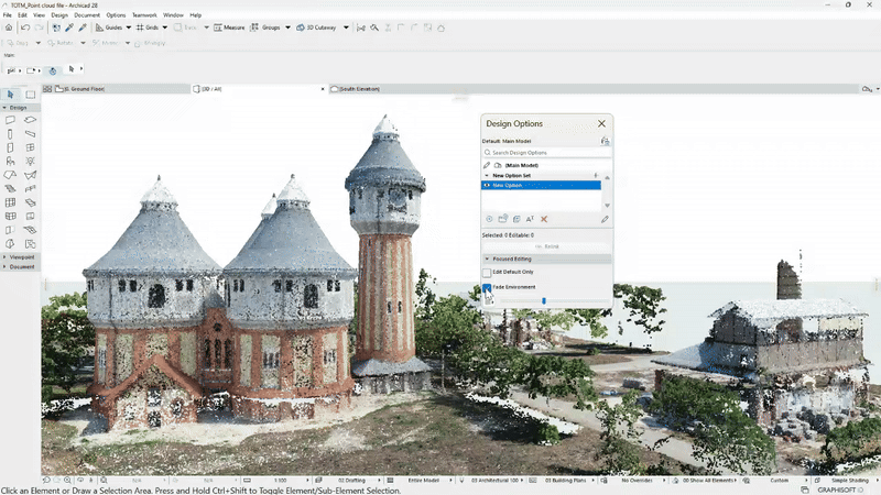

Visibility of the point cloud can be controlled without affecting other elements by placing it into a passive Design Option. In this way, the point cloud remains available as a reference but can be quickly shown or hidden during modeling.
  1. Open the Design Options palette via Design > Design Options.
    If the palette is not visible, it can be enabled under Window > Palettes > Design Options.
  2. Create a new Design Option set by clicking New Option Set, then add a New Option.
    Create New Option in Design Option paletteCreate New Option in Design Option palette
  3. Move the point cloud to New Option
    • Select the point cloud in your model.
    • In the Design Options palette, assign it to the New Option by right-clicking on it and selecting “Link Selected Elements”.
  4. Toggle the point cloud on/off
    • When the option is turned off, the point cloud is hidden without affecting other elements.
    • Since the Design Options palette is non-modal, it stays open, making toggling quick.
      Ative ou desative facilmente a nuvem de pontos com as Opções de Projeto.Ative ou desative facilmente a nuvem de pontos com as Opções de Projeto.
Fading and locking the point cloud for better visibility
Use the Fade Environment option to fade the Point Cloud, reducing its visual impact while modeling new elements. This helps maintain reference visibility without it dominating the view.
To prevent accidental selection while keeping the Point Cloud visible for reference, use the Lock command by selecting the Point Cloud and go to Edit > Locking > Lock. This keeps the Point Cloud in place while allowing snap points to remain active.
This method supports a smoother smoother by highlighting relevant elements and locking references such as a point cloud (similarly to the Trace Reference feature)
