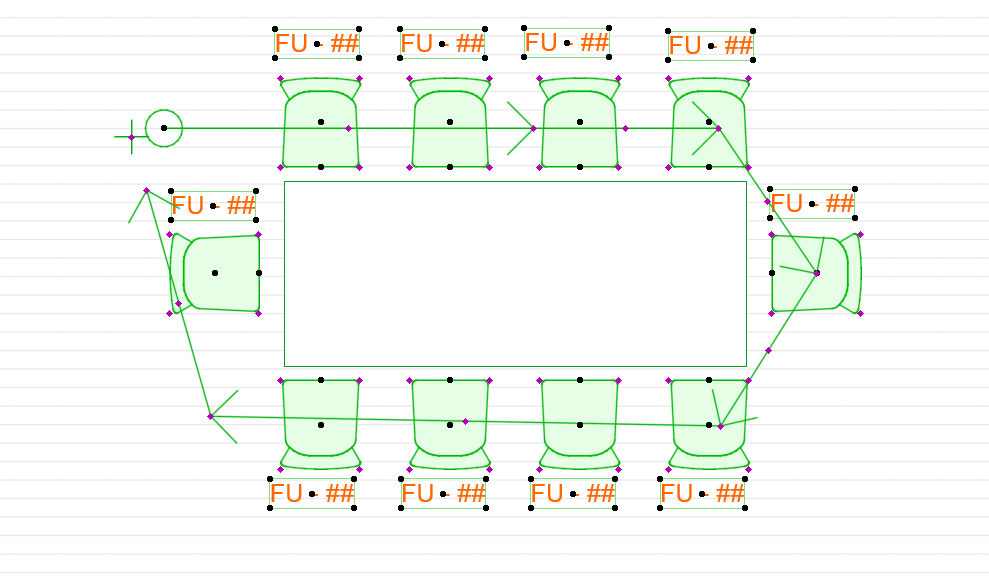

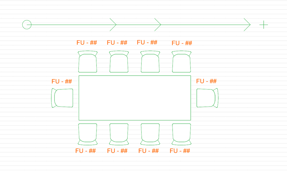

Place a polyline in your floor plan – no separate object is required (as the script now works directly with polylines).
Select elements and the polyline you want to use as the numbering guide.
For labels, use the Label Tool; these are not generated automatically by the script.

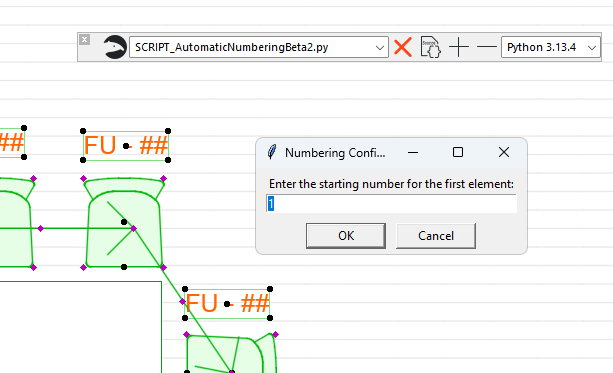

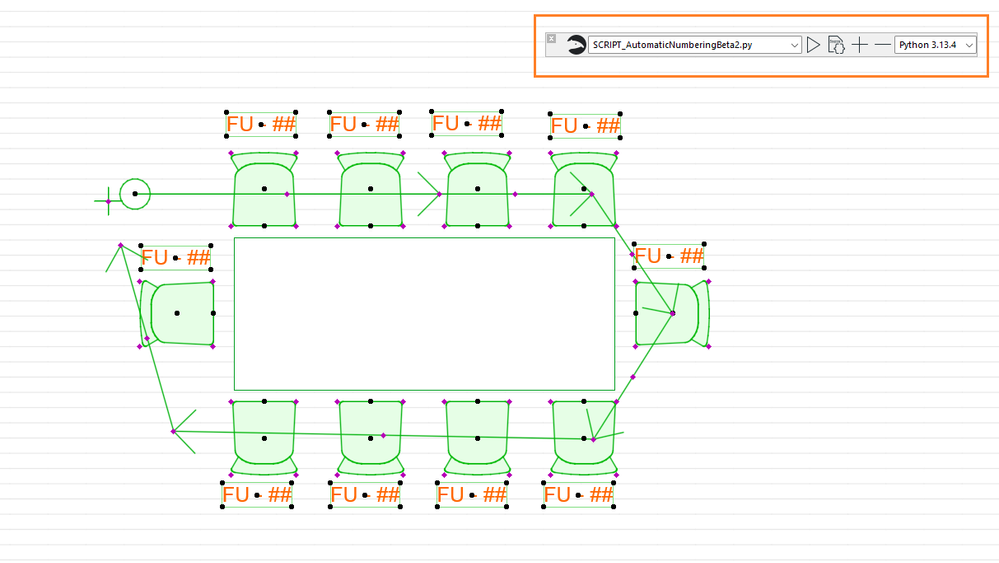

Run the script
Open via the Python Palette or double-click the .py file.
It will connect with the running Archicad instance.
Enter the starting number when prompted (e.g., 1, 101, etc.).

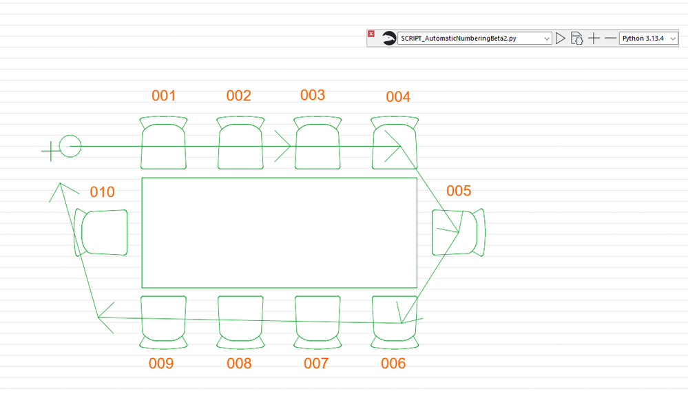

The script then automatically updates element IDs based on their sequential position along the polyline.
Collects polyline coordinates.
Identifies the center point of each selected element.
Matches each element to the closest point along the polyline.
Sorts elements in order along the polyline.
Assigns element IDs in that spatial order.
This workflow transforms what is normally a slow, manual operation into a streamlined automated process. Elements are numbered consistently, errors are reduced, and spatial logic is preserved throughout the project. Whether numbering rooms, parking spaces, or pieces of furniture, this approach delivers both speed and accuracy.
