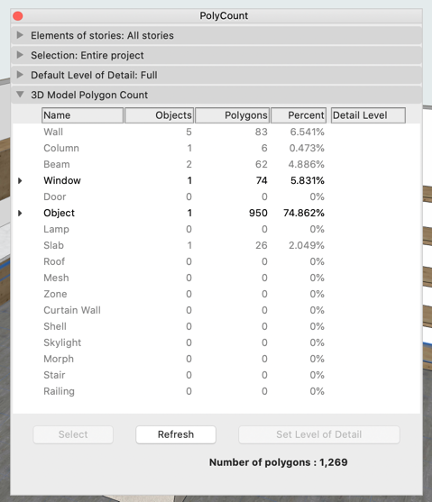

The quickest and easiest way to review the number of polygons in a project is to install the Archicad Goodies and use the PolyCount palette.
Once installed, you’ll find the PolyCount palette under Window/Palettes/PolyCount. When opening, it will check your model (based on what’s visible), so it may take some time if you have all layers on. Once you review the overall list, you can start to pinpoint the culprits – for example it may be an object that’s been imported into Archicad. More on that later.
Download Goodies (contains Polygon Count Add-On) here.
Use the PolyCount Palette to identify the number of Polygons by Tool, and by Object.

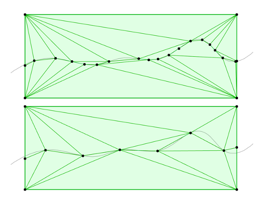

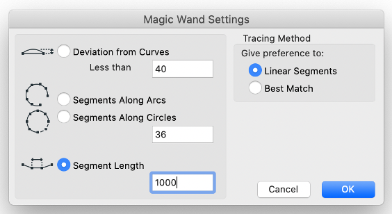

Magic Wand and Mesh
When creating a Mesh with Magic Wand, such as from a CAD plan or drawn 2D elements, contour lines will be created as straight segments that best match the original 2D.
To control this segmentation behavior and ensure the 2D contours are using a spline or arcs, review the Magic Wand Settings under the Design menu. Setting the 'Deviation from Curve' to a higher number or changing it to 'Segment Length', for example, can create fewer segments. If the result is too broad, undo, and adjust the values to find the balance between too many points and not enough.
If the 2D contours are made of straight segments (but have too many points), then try to Magic Wand these lines or polyline with an Archicad spline first. Hide the original lines and then create Mesh contours using the above Magic Wand settings from this new spline instead. Using the spline as a guide can generate simplified Mesh contours which wouldn’t be possible directly via the original lines and polyline. Before creating the spline though, it may be worth running Linework Consolidation as this may also simplify the lines.
Mesh contours using Magic Wand: above – Best Match with less than 40mm deviation, and below – Linear 2000mm Segments.
After modifying these Magic Wand Settings, don’t forget to set them back as this will affect any future Magic Wand-ing in the project. This setting is stored to your user preferences, so it won’t affect your Teamwork colleagues.

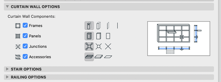

When working with these hierarchical elements, review the Model View Options (MVO) that sets the details of these elements. For example, keep an MVO set that simplifies their geometries, and use that for general work. Curtain Wall components can each be set to different levels of complexity whilst retaining their original colours.
picture-6.pngModel View Options panel for Curtain Wall
Learn more about Model View Options for Curtain Walls.

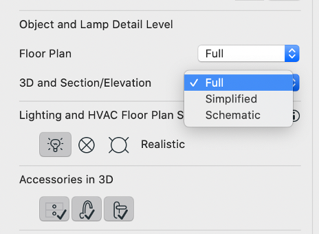

Archicad Objects, Doors and Windows
Like the hierarchical elements above, GDL objects in the Archicad Library are also scripted to take advantage of MVO settings. For example, set Objects, Doors and Windows to be displayed as Simplified or Schematic, and Handles/Knobs/Taps to be turned off. Inside the Objects Settings, like in the Railing example above, there are settings to modify the resolution of curves as well.
Under Miscellaneous Settings for Library Parts in Model View Options, set Object Detail Level (if Object's Detail Level is set to 'by MVO'), and turn off Accessories.
Most GDL objects will have settings to control curve resolution, a lower number will result in fewer polygons, but a more jagged look.
When generating your own objects, you can script with similar control such as by using the RESOL command, ‘RESOL 36’ would result in 36 segments around a circle. Better yet, create a parameter to allow customization of this value in the Object Settings. Alternatively, take a look at the Library Part Marker, to create your own objects with the same 3 different levels of detail as those from the Archicad Library.
